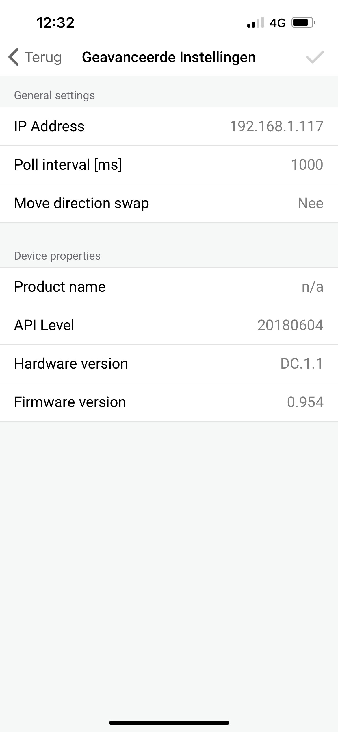

The shutterbox DC still doesn’t work
If it helps I could donate a shutterboxDC to you…
Good to know that wLightBox works. It must have been something with it as the driver works for many, many Homeys and I didn’t see anything in the code that could make this problem.

You may try the test version now. I think I found the bug and it should work now.
Hi Pjotr,
Yes, it works !!!
And you fixed it faster than I could hope for…

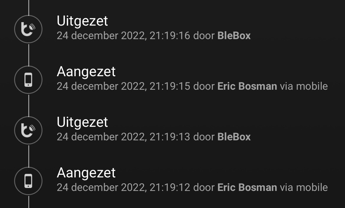

In homey if I press the button to turn the ledstrip on, it goes on, but after a second it goes off again.
In the history it says:
Turned on by mobile
Turned off by Blebox
If I turn it on using the slider it does stay on.
If I try to turn it on from a flow, it also turns off after a second.
Maybe something to check before you release the update you mentioned earlier…
Have a nice Christmas !
I checked with my wLightBox but it behaves normally… if in history as source BleBox is shown it means that this change came from the wLightBox somehow.

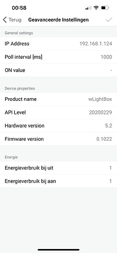

Please send me a screenshot of your advanced settings page for the wLightBox in Homey.
It,s in Dutch language ofcourse :slight_smile:
You have to fill in an ON Value. It’s the same mistake I made.

Hmm, I saw that post, but didn’t link it directly with my issue.
I did try to fill that field but it didn’t seem to accept any value.
I am not that familiar with hex-values, but I will look into it.
Never too old to learn something :grinning:
000000FF is white 100 % dimlevel :wink:

Oké, I managed to set the right color as ON value using a HUE color calculator.
Using a flow I can now first turn it on to the prefered standard color, and after 1 second set it to any other color….
So issue is solved for me !
