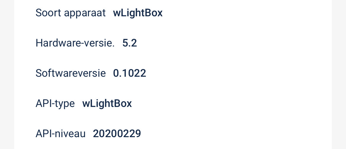

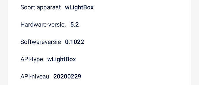

Just received and connected the WLightbox V2 leddriver. Works great in de IOS app, but Homey can’t find any new devices….
So if you could provide a patch for the driver, that would be great !

wLightBox with API Level 20200229 is already supported by the driver. If Homey can’t find it, the problem might be that your router cuts off mDNS-SD messages (I’ve had such a problem with Mikrotik routers). So the major question is if you have any other BleBox devices that already work with Homey (with auto-discovery)?

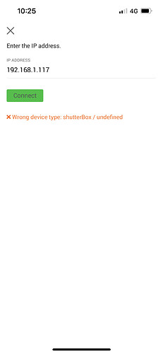

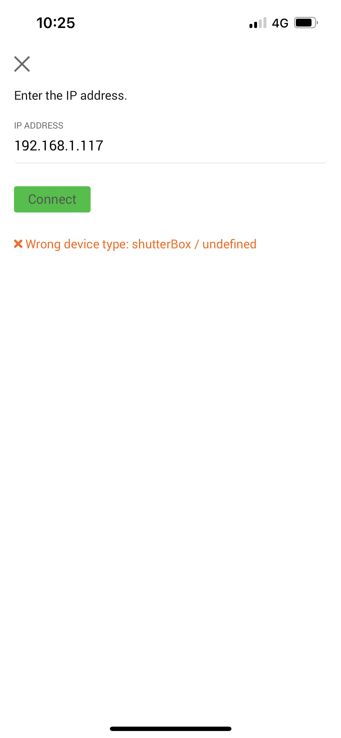

Blockquote No luck here also
OK, found the bug, 3.4.2 is now in the test channel - please try it. But I think you’ve put wrong IP address (homey wanted to write a message that it’s a wrong device type on that IP, but it couldn’t resolve the message translation).

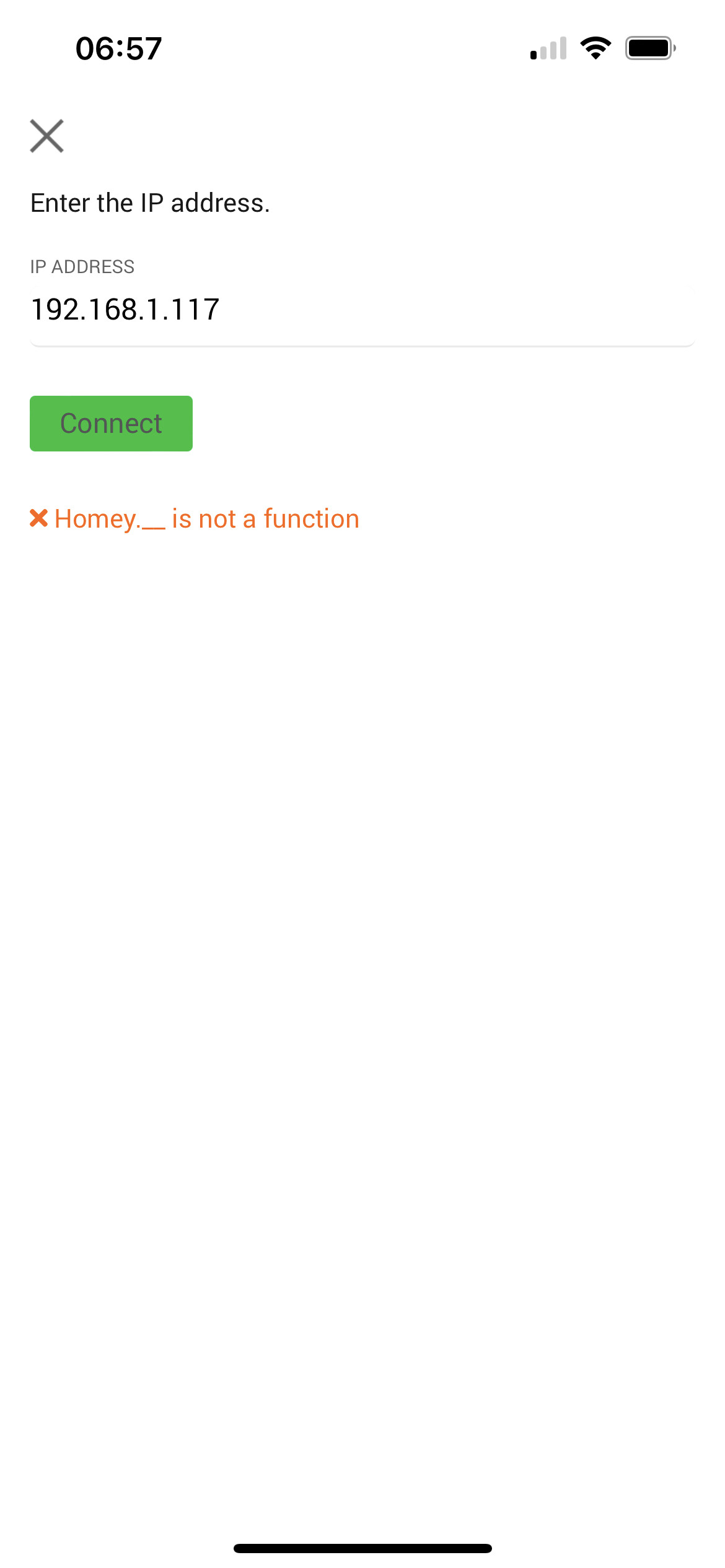

Blockquote. Hi, just doublechecked the IP of the shutterbox and it’s correct.

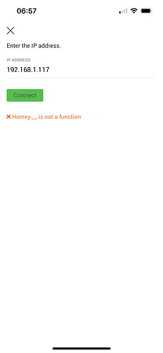

I now get another error.
Another fix, please check the 3.4.3

Just tried to add the shutterboxDC

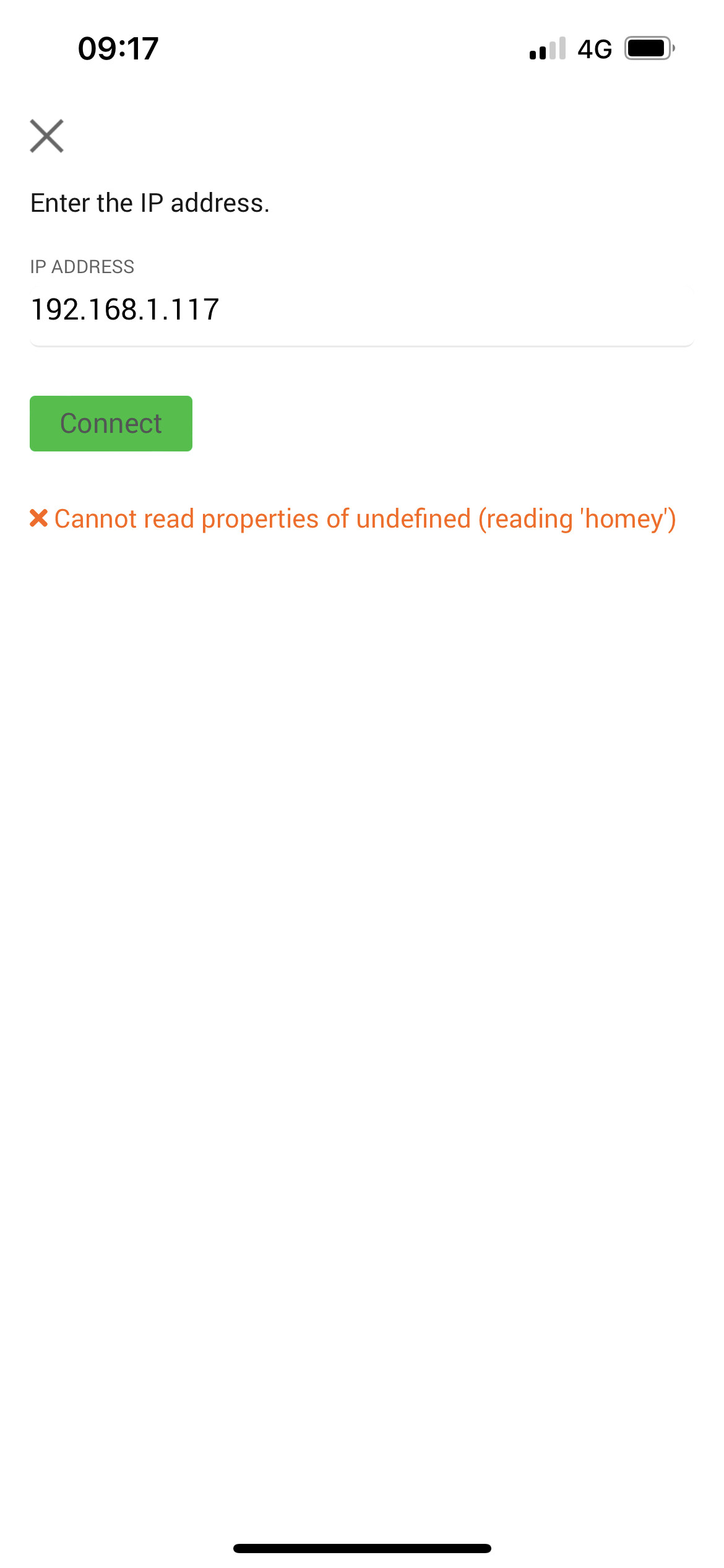

And a new error.
When you’ll be at home please issue in your web browser: http://192.168.1.117/api/device/state and paste me the answer. I think shutterBoxDC answers differently than normal shutterBox and I need to see the exact answer.
I have an iPhone, but i might have an Android phone or tablet available
{“device”:{“deviceName”:“Shutterbox 3”,“type”:“shutterBox”,“fv”:“0.954”,“hv”:“DC.1.1”,“universe”:0,“apiLevel”:“20180604”,“id”:“96b97e0340a0”,“ip”:“192.168.1.117”,“availableFv”:null}}
I can see that shutterBoxDC doesn’t publish ‘product’ field which I expected. I’ve made a bug fix, please test 3.4.4.
