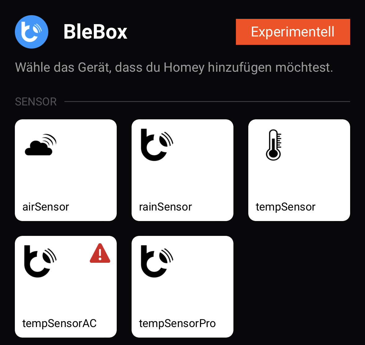

I installed the 3.5.2. restarted the homey, restarted the app, but I cannot add the sensor.
There is a little ! (exclamation mark) in the button of the tempSensorAC.
Hope you can fix that.

The tempSensorAC_v2 is working perfectly fine after the update to 3.5.3
Thanks @Piotr_Grochowski for your great work.

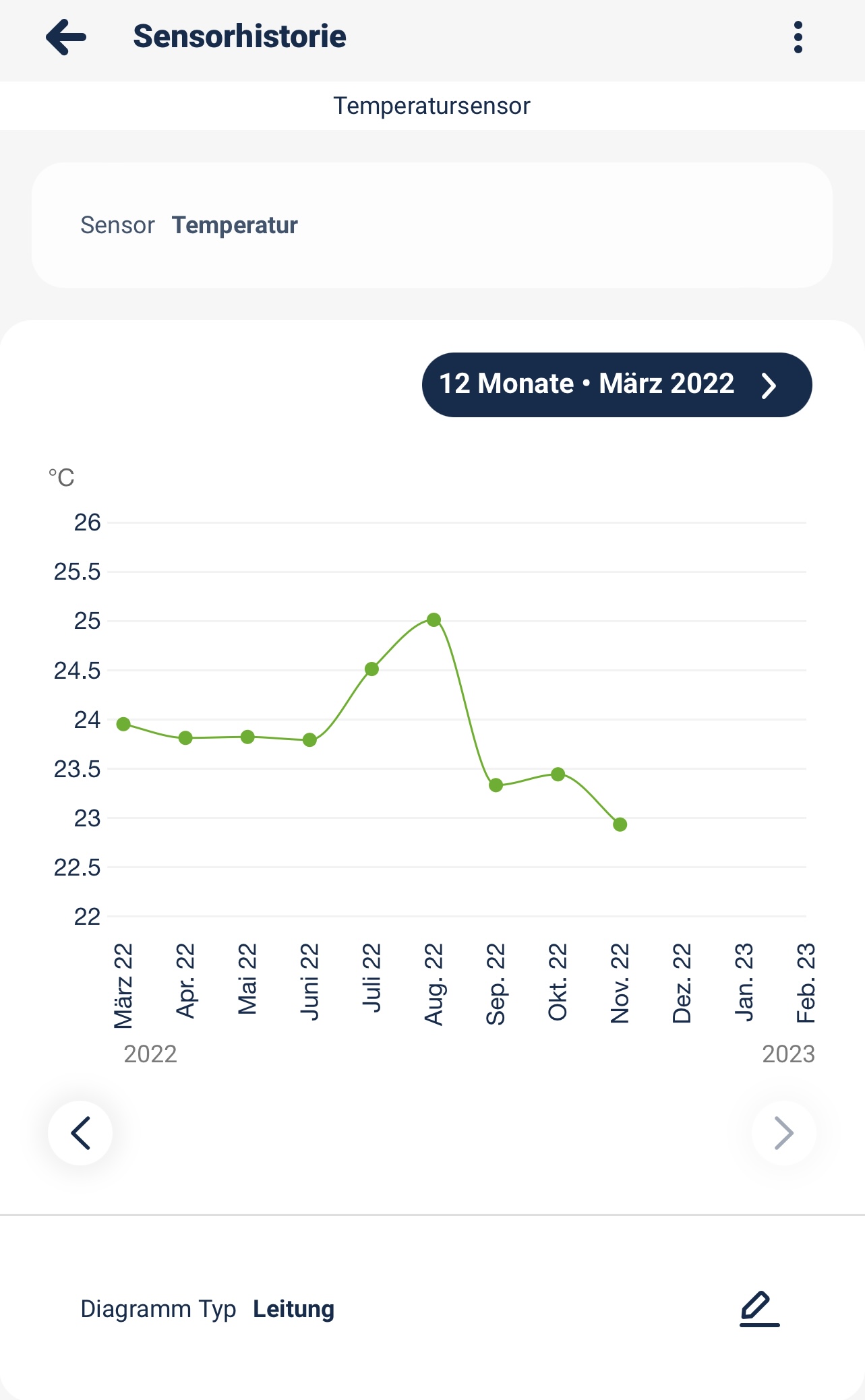

I can confirm the behavior. Since 25.02.2023 at 00:00 the values are no longer updated:
At this time, I didn’t make any changes at Homey (e.g., firmware update, app updated), nor did I make any changes at the WLAN.
I disconnected the WiFi connection to the temperature sensor and reconnected it. I replaced the USB power supply. All without success.
Diagnostic report no.: f088f6aa-907d-4112-b6a3-75bb7bf21083
But what’s even crazier is that since November 16, 2022, no temperature values have been displayed in the bleBox app:
