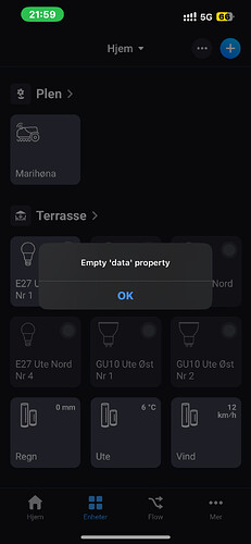

I can’t get in touch with my spa anymore:(

Still having the issue that no values are updating.
@OH2TH please send a report
Frozen values, retrieves new values after a app-restart. Report: e11d27cd-250b-401c-86f4-b55878e49972

There must be something wrong with BWA’s authentication platform because when I’m trying to add new spa (I’ve reinstalled the app), I’m getting the “The provided credentials are not valid.” error message for credentials that work fine on the https://iot.controlmyspa.com/portal/spas portal. When I’m trying to change the password there, I always get the:
error message no matter what new passord I’m trying to choose…
The error has been there since i was forced to change password by the CMS-app. Have you been forced to change password?
I haven’t. But I gave it a try since the current password (that works fine with the balboa mobile app and their portal) was rejected as invalid when used in homey balboa app to add new device. So I’m stuck with my current password (which I don’t care much about) but Balboa’s servers keep rejecting Martijn app’s attempts to log-in even though he’s updated it 3 times over the past few days…
@Martijn - I’ve sent you the log file yesterday and I’ll send you another one in 10 minutes.
