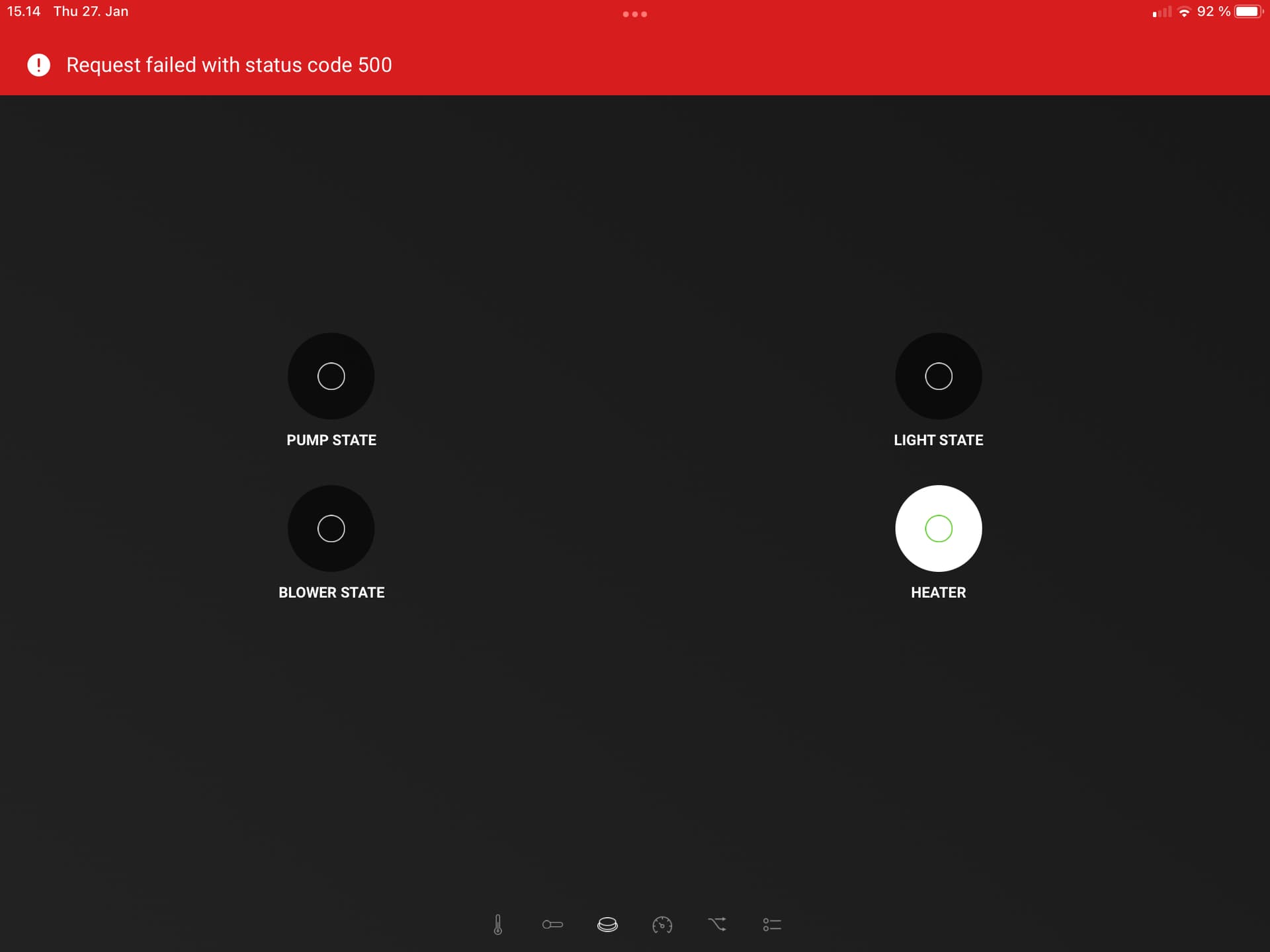

Get an error when clicking any of those buttons.
Diag report sent. Then restarted app and commands are successful.
