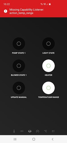

Temperature range
  • Pressing the function gives error “Missing Capability Listener: action_temp_range”
  • English translation “Temperature range” missing
  • Button status does change when changed from CMS mobile app.

Temperature range
  • Status in Homey app updates ok, when mode changed in CMS App
  • But when changing mode from High to Low, seems to fail
    • no change in CMS app, and the Homey app restores the state back to High
  • Changing from Low to High in Homey App works ok.
