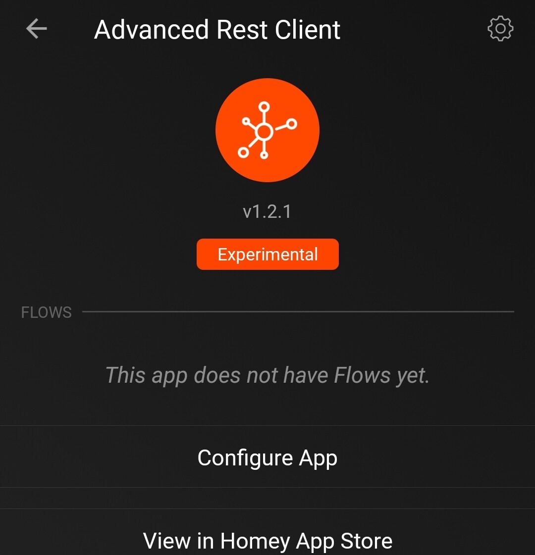

I just installed the app, Homey is release 5.
Created a custom header.
The tried to create a request. But the dialog cannot be saved even when all boxes are filled in.
The save button V remains gray.
What am I doing wrong?
