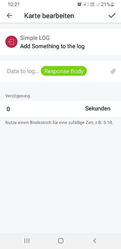

  3. Create another flow card called ‘request performed’ and choose “Advanced Rest Client (ARC)” → “Request completed” as trigger. As action choose “Simple Log” → “Add something to the log” and set the “Response Body” token as text.

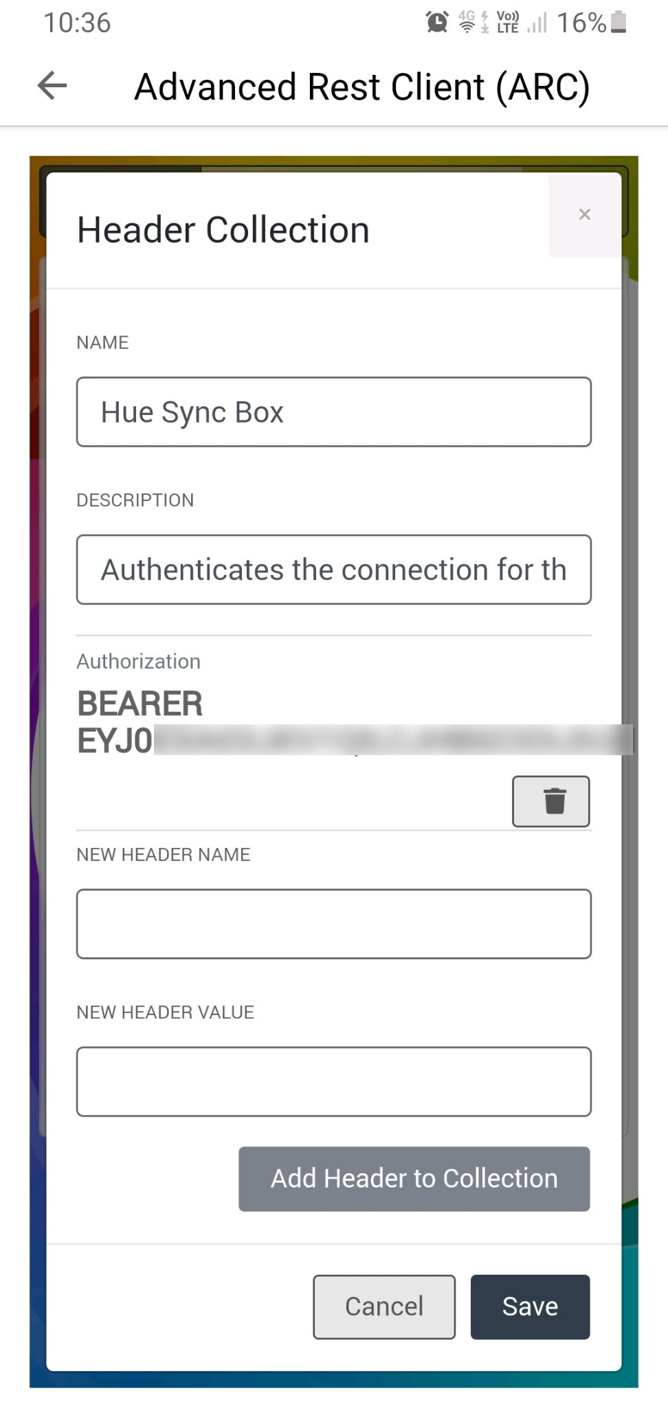

Step 3 - Create custom header collection
Go to the configuration of the “Advanced Rest Client” app → headers and click “Add Collection”. Give it a name and description. In “New Header Name” put “Authorization” and in “New Header Value” put “Bearer [the cryptic token from above]”. Click “Add Header to Collection” and then “Save” to complete.

1 issue… i keep getting the error: Invalid Token
this while i think i did everything right. I did got a very long base64 and then i decoded it and then i got a readable json output but after the regular, was followed by jibberjabber to me. So i thought i needed to leave out everything after the double ==
i decoded the base64 again en now i get only normal readable json output. But still; invalid token.
Any idea?
What did you decode? There should be no need to do so…
i know. but i wanted to know if the data in the base64 code is right. so i decoded it to see.
i guess you don’t have an idea?
I have but I am a bit short on time and I still did not get 100% what you did;) So retrieving the token worked for you? How does your header collection then look like?
Ya, i got the token, that went well. However, it is not an token but a base64 encoded piece of json. But that is not important. I have that received by the first part of the tutorial.
