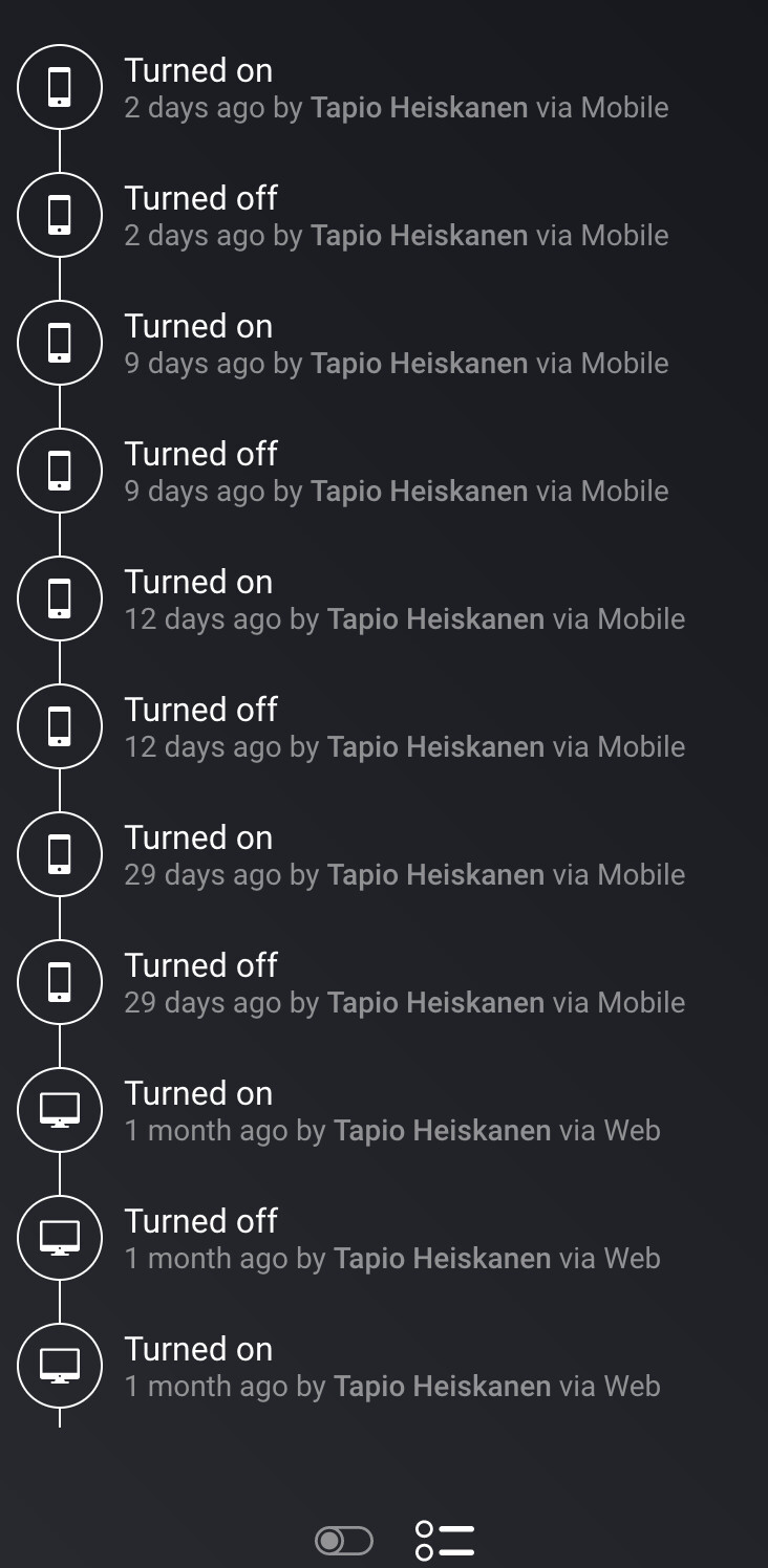

Ok, those are not something for insights, as they would be something measurable. Will need to investigate how to add those event to the history screen of device. I assume you are talking about this screen:
The Enable/Disable toggle is doable, so that you get the history. However updated and triggered are not on/off capabilities that would have insights to enable.

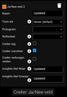

Here, just to give an idea how it could be handled if you want to show the user a time based “event”:
I have createn an AVD as example:
[tef:AVD:"H4sIAAAAAAACA41U2W6jSBT9lRavTssGbDCR5gEbs9jsBuxkNGqxlKFYiq3A4Fb/++DOpJNWMprhpcQ9555zj2r5TkSghyFQwhIRj4S8bBX+5dvyNOk4LhdY1m19GH3kFSoXNdRFWJ7Kvb0/VgceUFlnRnLOV1vLzJ5ivmfZVLBto/egQQ6smYqzomNCFmCmxWx/Gy/kbE4Lp+jpIsTWDAxrwDr1SMpOWXCq5QvJJV3P0S6rXWubuSjj0GLYx06XjDSYVzNJDtLnWlAHSooH7XCaNzcLk936HKw5KVJ0g7ktPcNlggKu6lanuNXMCBDdMtLSm7cdTHEfSSGNIlMKeNw7Qyx5aNnm8yAJs0Knj705PKcwrdenPpqP/UGg1uaB7dg+zLza1hvbafJNEIyFowVmde2DGSrm5t6zBdN0C+28DzaG1Rgt00stE8XGc5fdbsyorfNRK2UWB6YEz/yCt2yFEiOkuzvWABtrsS9OVbi3m7PVDtBdrCxVizf5qCMxlLjZLWBk6aZSHX+Ny1Ig04MCaHurXBsr43gZY3u/y9RAQ1eHqeJkle80WTxIuzotjc1WRAhu3VzOQ6QsJRU+LZ3EOlZiGpfP+hnBrh4leJCjY1kbXAjYq8dofF7Eoq0q+XCo9rODexXdRmuosdmW2sC3nCTpDmMZtrB5gpWS7BzXsS19wD59MvzZVUV8rM4rx1C5zlFUcmg9q/I3pXeK+lB5Hm+Co8UzmizEZrEPQkqmxEAPQULiM0jJTM0OM3PO8LNr13kjSzGiLNV+zZshkllB5NjI73gpTTaWg7OgkLsdk6ixs/Ke9ILeiFRS52f5tjimpwOI3JPJlimTePoQ3UBP5n3ia5ApIdlQRpcX7pxWb/1yq4UImlwpTGf/D+KBCLsWl8X9XrTE4/cfD0TZwBgiP1ei6aLQS4Zb0+zyq79cM1+XYRh85QJm+iUpjvZXq4hcg0mkBRhDFN8VCIBAE4/fej/vwLe7LPYRJh5Rl+cPBOqKADTGxQEDFiHIo6ll8VbWf66fAJuyzIGPXhHqHdJhXKJPWrZ+ARr/E0CF7XvvMJ9WosQJaKYkwYsRqU/dU9lAX4zL5V192wAfAzEvr1u/uStc/LwFb/gRVH4zMbZ+5QcwhxiCjyQFtTBOcOtAnAOn6e5OTtcgEH0xEPEvPPGu8Y7421jHpLzyP3Og8pN5X4WIRzy5/UKpf1K6VTSRorc26j9iUv8nJvVZzI9Wn4b8SPuVsAWoLZsPs/4ecTrHLw/+6z7KlCNPPT7x+OdfP/4GepdL0A4GAAA=":/tef]

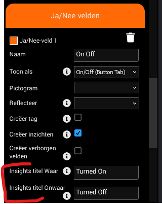

Here is a device with a normal OnOff.
Then add another OnOff/Button capability, and set the InsightsTitelTrue and InsightsTitleFalse to the same value, like, updated.
Now, the second Insights capability can be a sensor value or even hidden (no UI-tab) (not in my example tho).
Every time you want Updated to be reflected to the user, toggle the value of Updated around one time.
Result:

Thanks @Arie_J_Godschalk, for this. The device enable / disable is already ok since that is a boolean capability and insights enabled with appropriate capabilityOptions to give proper title.

As you can see by my example (HP2019) i dont seem that have that issue.
Indeed, that was the idea of my example :wink:
