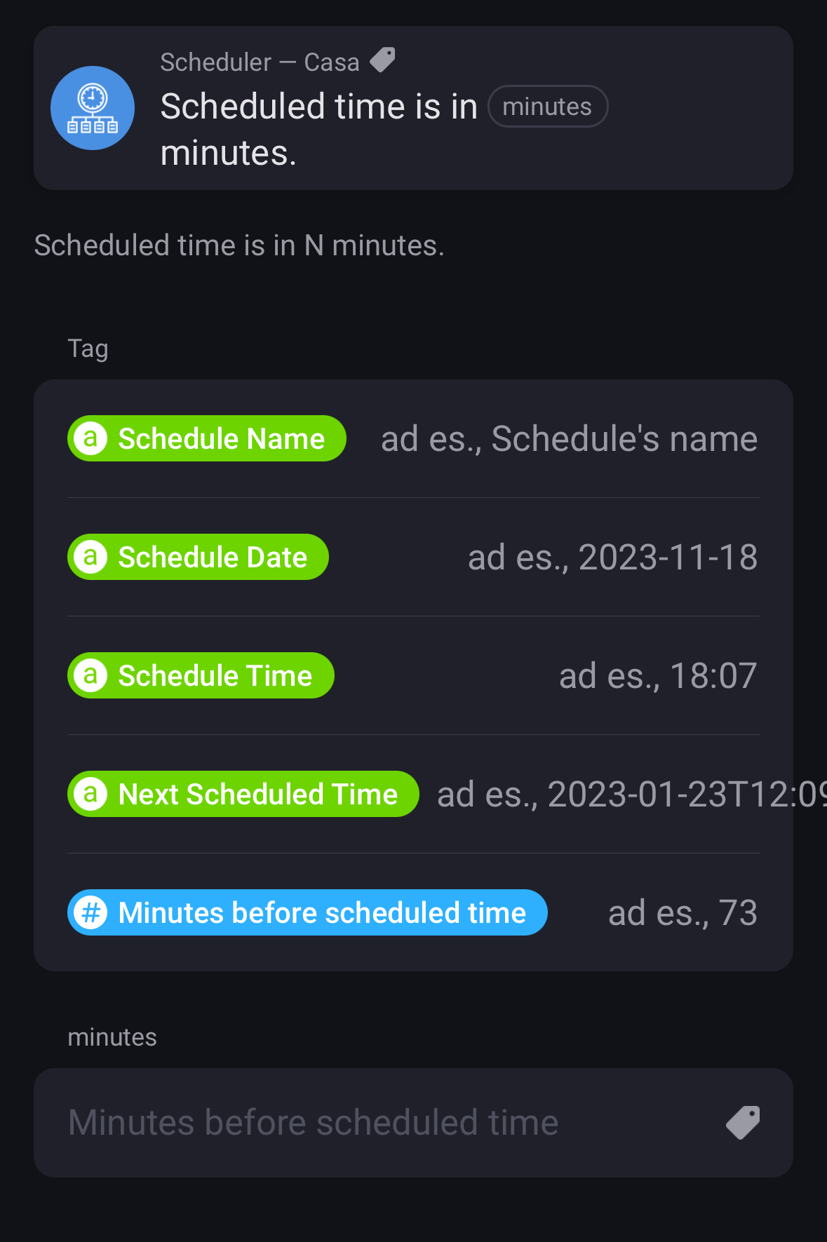

My image explain the only way to use Chronograph, via Flows, because it’s impossibile to add “Chronograph devices”.
I see that Action Scheduler has the same complexity.
I have to add a device with a Scheduler at a certain time (not period of time) and for certain days, to use it later in Flows.
But in Flows the dark way of running things returns.
I don’t know what the tags refer to if I can only indicate minutes, and are “minutes before scheduled time”. Why these limitations?
