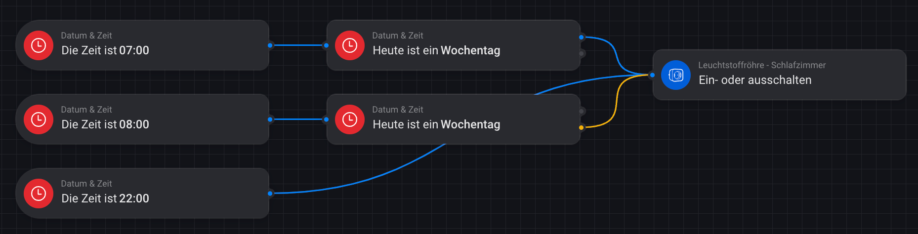

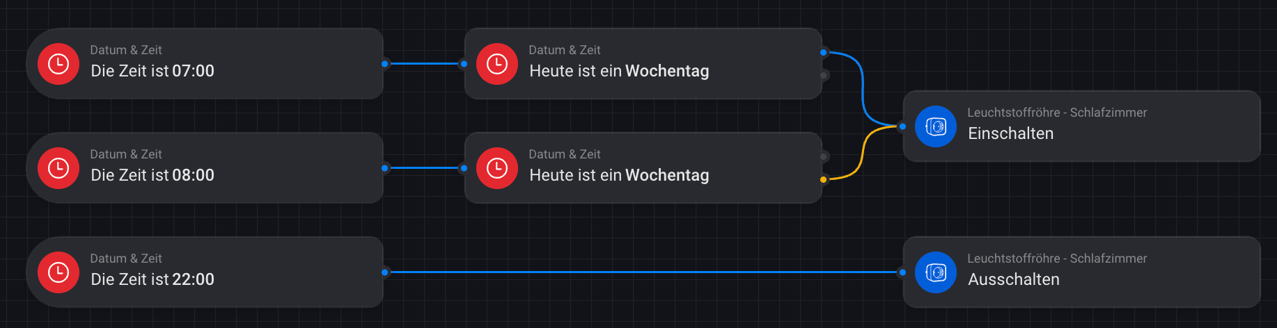

Just to show how such a flow can look like with Advanced Flow, because nobody has done it yet:
However, a requirement for this flow is that the SmartPlug has the correct status (on/off) at the times.
This flow is the safe option. The state (on/off) of the SmartPlug doesn’t matter:
You have to understand the principle first, then it’s actually quite simple.
Thanks fantross, I didn’t know you could combine multiple WHEN-triggers in 1 flow. That certainly reduces the amount of flows needed! And I assume once you’ve got one of these flows set up correctly, it can be duplicated to other devices as well, so you don’t have to reinvent the wheel everytime :slight_smile:
