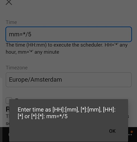

I was trying to use the mm=*/5 for every 5 minutes, but
Ah, need to clarify the hint, so the sample usage would be:
HH:mm where
  • HH can be 0-23 or * for every hour or */n for every nth hour
  • mm can be 0-59 or * for every minute or */n for every nth minute
For example
  • 12:30 exact time
  • *:30 every hour’s 30th minute
  • 5:*/5 on the 5th hour every 5 minutes
  • :/15 every 15 minutes
The syntax is similar to crontab style which used by the library I used.
Updated this to the first post now also.
Got it now, thanks! :heart:
