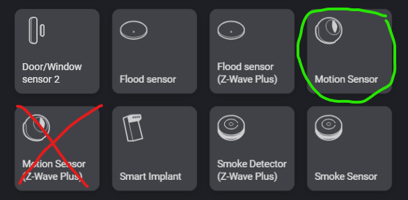

Have you added your motion sensor using non-secure or secure connection?
If secure, try adding it in non-secure mode, it’s more reliable:
I have 4 Fibaro Motion Sensors, and 3 Aeotec TriSensors, and Fibaro is working a way better for me.
That’s not what those 2 do, they will both include your device as unsecure as both are either unsecure or only S0 (which gets include insecure nonetheless in Homey).
There are 2 because 1 is a very old type with less options and parameters, the other is the “newer” but still 5/6 years old (if not older).
These are two different devices indeed. I can’t add the MS when using the non Z-wave option.
