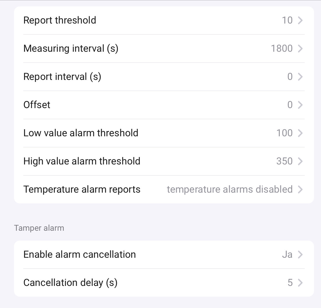

Anyone managed to change the reporting interval of the Fibaro Door sensor 2?
Regardless of what values I put in (an yes… wakes up the sensor after saving the new parameters) the sensor always reports Temperature and battery status on a 5min interval:
Have several of them and they all do the same.
Currently have these parameter:
You experience a bug in the app screen as discussed in the last comments of https://community.homey.app/t/device-logs/88455. It is likely not the device itself reporting at this interval. You could check on one of the other tabs displaying these values. Click on that value once to see last reporting time. Or check on insights.
The sensor has to be waken up before saving, not after!
No, that is not accurate…
If the device is waken up before saving it is a big risk that it is asleep again and don’t get that new settings. It is only awake for a short period of time and its is a risk that it falls asleep before getting the new settings.
If the device is waken up after saving, it will then get the new settings.
Your metod also works, but it can take a looooooong time before the device get the new setting. If it with your metod falls asleep again before it receives the new settings it will get the new settings next time it wakes up which will take 6 hours with the default settings.
The way you describe it is in deed written in the manual for the Fibaro door/window sensor 2, and other manuals. But I use “my” method for about 6 years, the changed data are always saved immediately, success rate about 100%.
Have you ever tried to save changed parameters on a Sensative Strip using your method?
Yes, with many sensors the wake-up time is very short, I mean it is usually about 5 seconds, but this is absolutely no problem. With some sensors from Aeotec, e.g. the multi sensor 6 powered by battery, the sensor is even kept awake for up to 10 minutes.
The method of changing and saving parameters without waking up the sensor so that the changed parameters are transmitted at the wake-up interval has never worked with my HP19.
We all have different solutions that works for us, done “my” metod since I started with z-Wave like 10 years ago and never failed.
This time it obviously wasn’t a settings issue, but rather a bug in the APP
