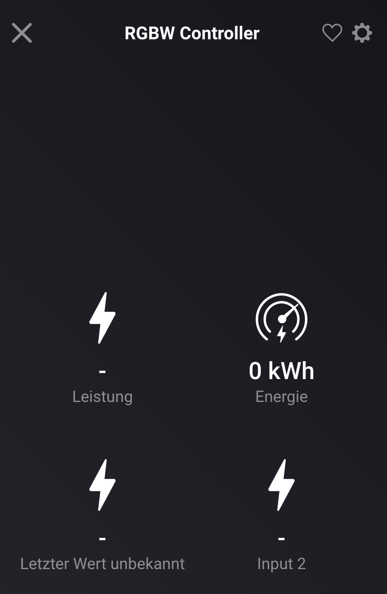

How is the reed contact connected to the inputs?
Looking at the diagram, it should switch them to GND
Screenshot from 2023-09-15 04-01-07
Hi Peter,
I’ve wired a button for testing instead of the reed. This is connected from GND to IN1. I see it switching in HC2 when i include the device there, but nothing when included on Homey. So the RGBW must be ok I guess.
Another RGBW used for the Bed light is working fine, but also shows ‘last value unknown’ on its Inputs. There must be a setting that I’m missing.
In HC2 I have set the mode to Inputs, not sure how this is done in Homey. I tried all LED strip types incl. other, but no luck so far.
UPDATE:
Ive updated the FW on the Dimmer and am now able to see reports at least in the Developer Tools.
However, there is still no indication of the swiching on the device no matter what the settings are (last value unknown never changed:
My settings are:
A simple scene wont trigger (also tried with input configured to analog)

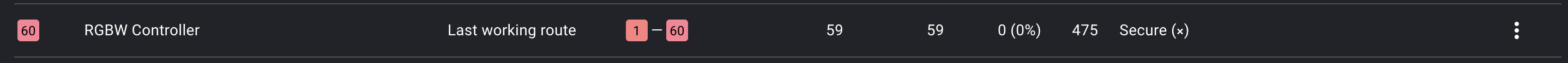

So, I did readout all parameters with Fibaro and tried to check if they are same in Homey, also added missing ones via RAW command zw_configuration_value
“14, 4, 39321; 1, 2,255; 15, 1, 1;30, 1, 0;38, 1, 10;39,2,600;49, 1, 1;71, 1, 1;73, 1, 0”
I come to the conclusion that the Homey Fibaro device must be the issue because I can clearly see that the signals appear on the Z-Wave network:
as well create Rx counts (475 from my button presses) on Z-wave device id 60 (after re-pairing):
However there is no data written in the measure_voltage.input 1:
hence I guess also not showing anything on the devices IN1.
Nothing more I can do on my side. Propably will use a relay switch with 24VAC to do the trick.
Thanks for all inputs - I learned again a lot!
I didn’t look into the results in any detail, but I think you did a great job. So for this reason I would share the knowledge with Athom so that they have a chance to fix it.
