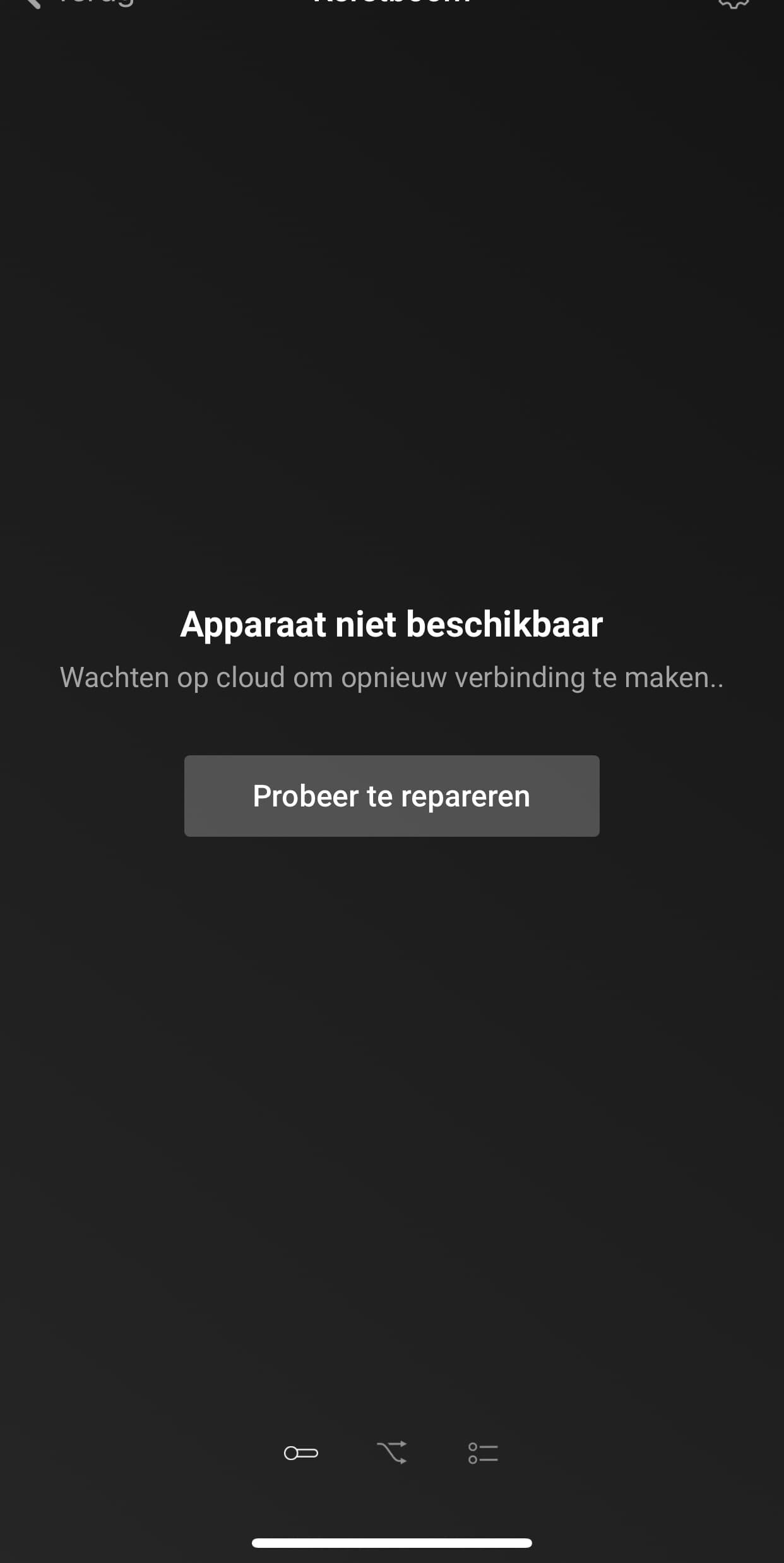

Cannot turn any Twinkly devices on/off. Have tried repair and updated to the test version.

Is software version important here? Like can it be too new? My Twinkly stays offline or “Wachten op apparaatgegevens init…”.
FW version 2.8.3
Unlikely. But if it does not init, then the authentication token must be “broken”. Try a device repair in that case. There is a known issue but it is not related to the Homey app itself.
Ah, ok. Unplugged the music dongle and did a reset of the lights. Now it’s connected. Dongle plugged in again and all connected it seems. Thnx for a great app!

Lights not responding
Message is connecting to the cloud

I have only just started to use the app again yesterday for Christmas lights. Installed version 4.0.14 and added the lights afresh. This morning the lights were no available so had to use the Repair option. It seemed to fail several times but when I closed the tile the triangle had gone and it was working.
So not sure why it went offline but also could be a refresh issue with the Repair task.

There are indeed several known issues in regards to connections. When this offline situation comes up. Does the status message in the unavailable device say “Device seems to be offline” or is there a different message?
