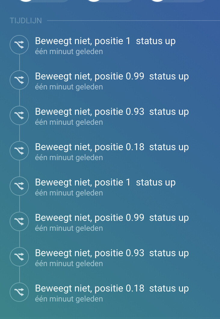

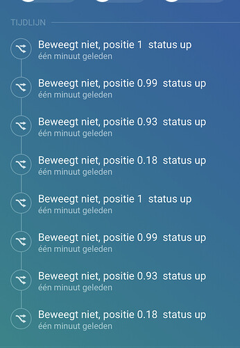

Using this flow:
https://homey.app/f/cjR6sD
I first used the remote to put it in MY and got this:
then cleared notifications, and remote up gave me:
The erratic order may be due to ansychronous effects

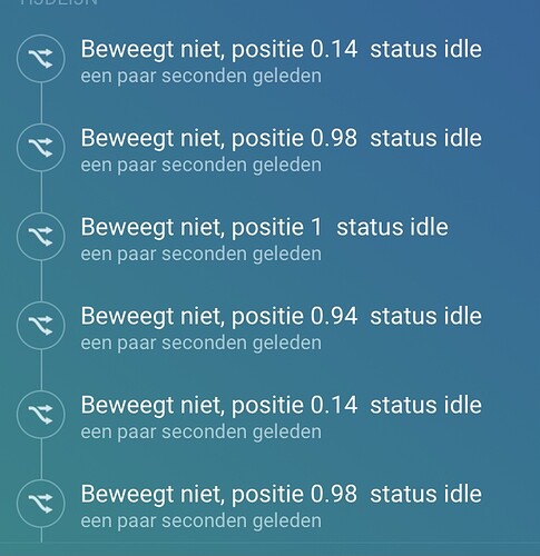

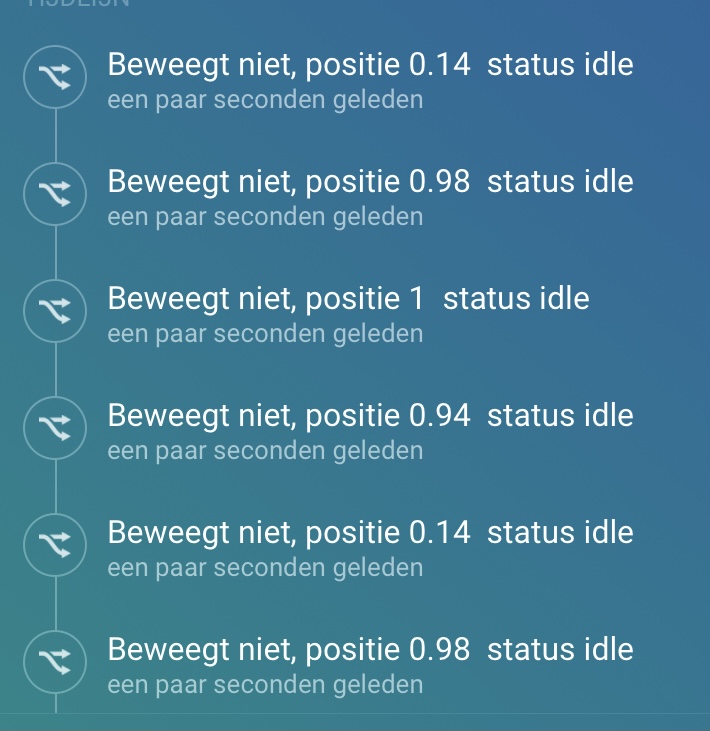

But to me it is not really useable. A lot of the positions displayed are not ones I asked for but intermediary ones. I issued only two commands, MY (I think about 0.17) and open. Homey thinks I also placed it in other positions.
These values came with a state “not moving”, which isn’t so if they are intermediary ones. This is probably because by the times they came though, the movement was already completed. Is Tahoma giving you multiple buffered values when you poll or something like that? Because it is definitely not real time, they come all at once some time after the actual fact.
So moving/not moving isn’t corresponding with the situation at the time of the provided position, and state is also useless because it issn’t representing the direction of the motor at the time. It says top, but it is idle in the top position. So what does idle mean then?I can’t tell the extra positions were arbitrary positions in between. I also can’t tell if the last one is the right one if they are handled asynchonously.
And mind you, the number extra positions differs each time. Sometimes I get so many Homey will disable the flow. I also doubt whether the action completed will be of any use if the action is performed with a Somfy remote. Will it say MY if I used that button? And what if I press down and then stop a little while later?

I tried a notification with both the local position tag and the actual state from the device. I can somewhat filter bad positions from that too by only using the position if they are the same. But as you can see, during testing my flows got disabled again. That is something I cannot protect myself from.
It would be nice if you could prevent a position storm by giving only the last position per blind if you get many at the same time.
It also gives me 0.95 numbers that should be 1 (1 is also there).
