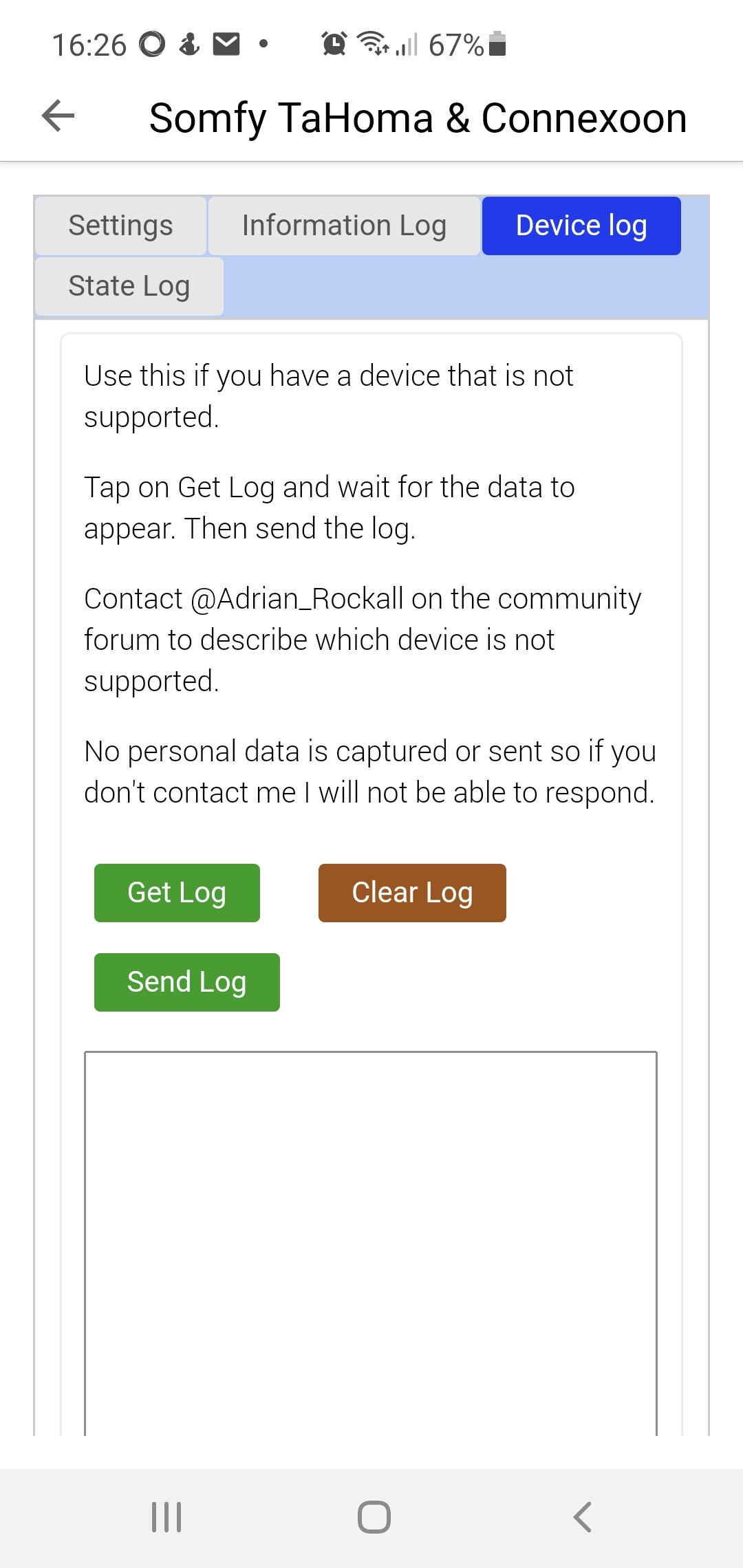

While Tahoma shows that status could you send be a device log from the Configure App screen. So tap on Get Log then when the list populates tap on Send Log.

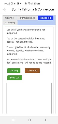

I couldn’t see a “get log” option but have sent the log from the “information log” tab page
It on the Device log tab

Can you confirm that Tahoma still had the warnings when you tapped on the Get Log button?
