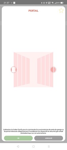

It looks like the command takes 1 parameter. What doe the control look like in Tahoma?
You have to select close or open then ok. FYI i have et remote keypop. With the same button you open, stop, close.

It’'s not giving up it’s secret easily this one. In the product video I see that it’s possible to open just one side so i wonder if the parameter is something to do with that. Can you open left and right independently plus both side together?
In tahoma you Can only open or Close the both in same Time. But, with the remote keypop (2 button), you Can open just one side (right) or the both. Depend wich button you press.

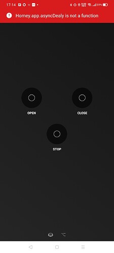

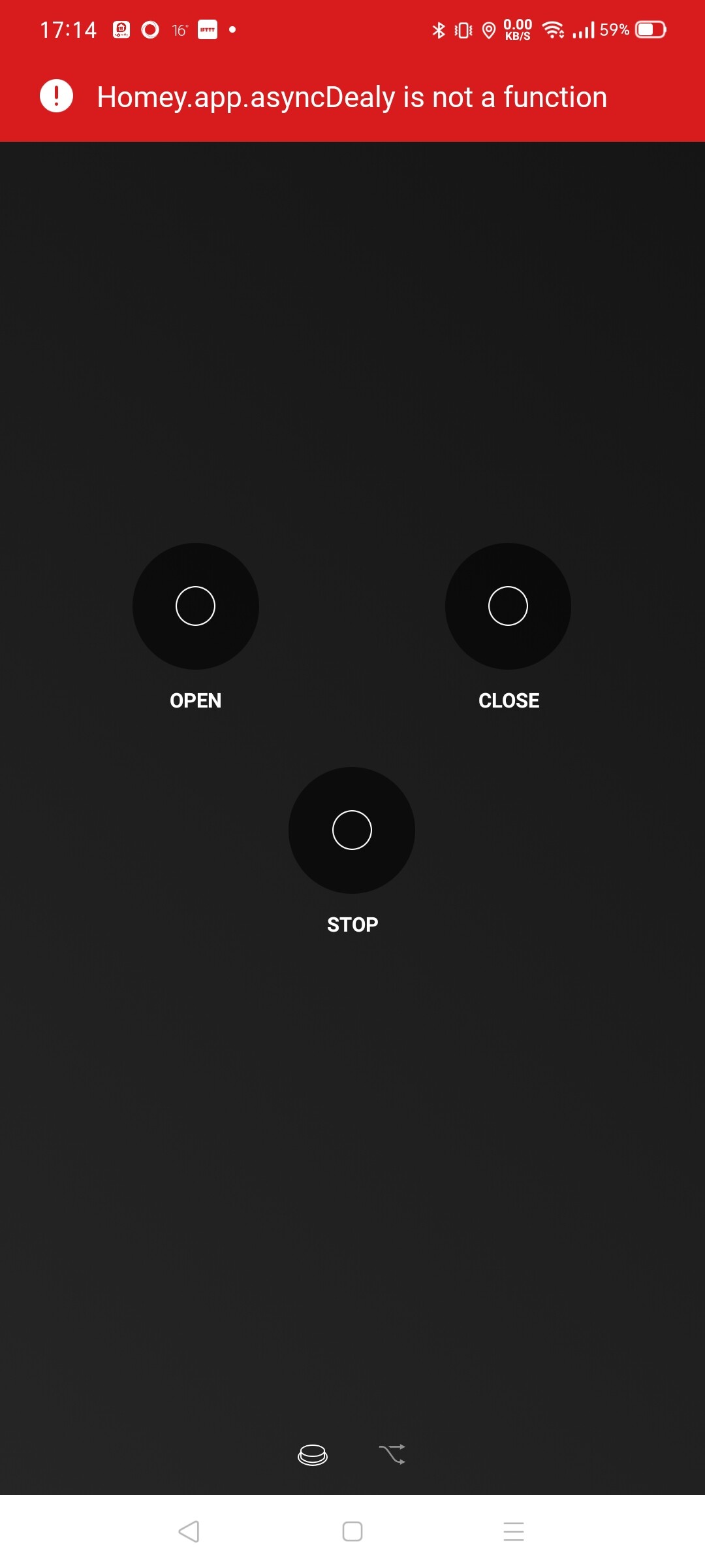

Without parametre on 2.1.60 (update auto) it work partialy.
I Can open or stop sometimes, never close, and when open or stop don’t work i have :
Oops, the error is caused by a typo, sorry. I have pushed a new test version to fix the error message.
Does anything happen for close?
Could you enable the Information log and send it to me after performing open, stop and close commands.
With New version all 3 button works.! Congratulations !!! :clap: :muscle:
