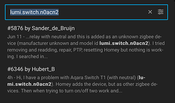

I have a problem with Aqara Switch T1 (with neutral) (lumi.switch.n0acn2). Homey adds the device, but as other zigbee devices. Then when trying to turn on/off two work and two others I get an error: Missing BasicZigbeeDevice instance for token
The reason is, that the Aqara Switch T1 (with neutral) with the device id lumi.switch.n0acn2 is still not supported.
Did a quick search:
You can also search the app changelog in the App Store. No result for lumi.switch.n0acn2.
What you have to do to request a new device, is explained in the first post of this topic.

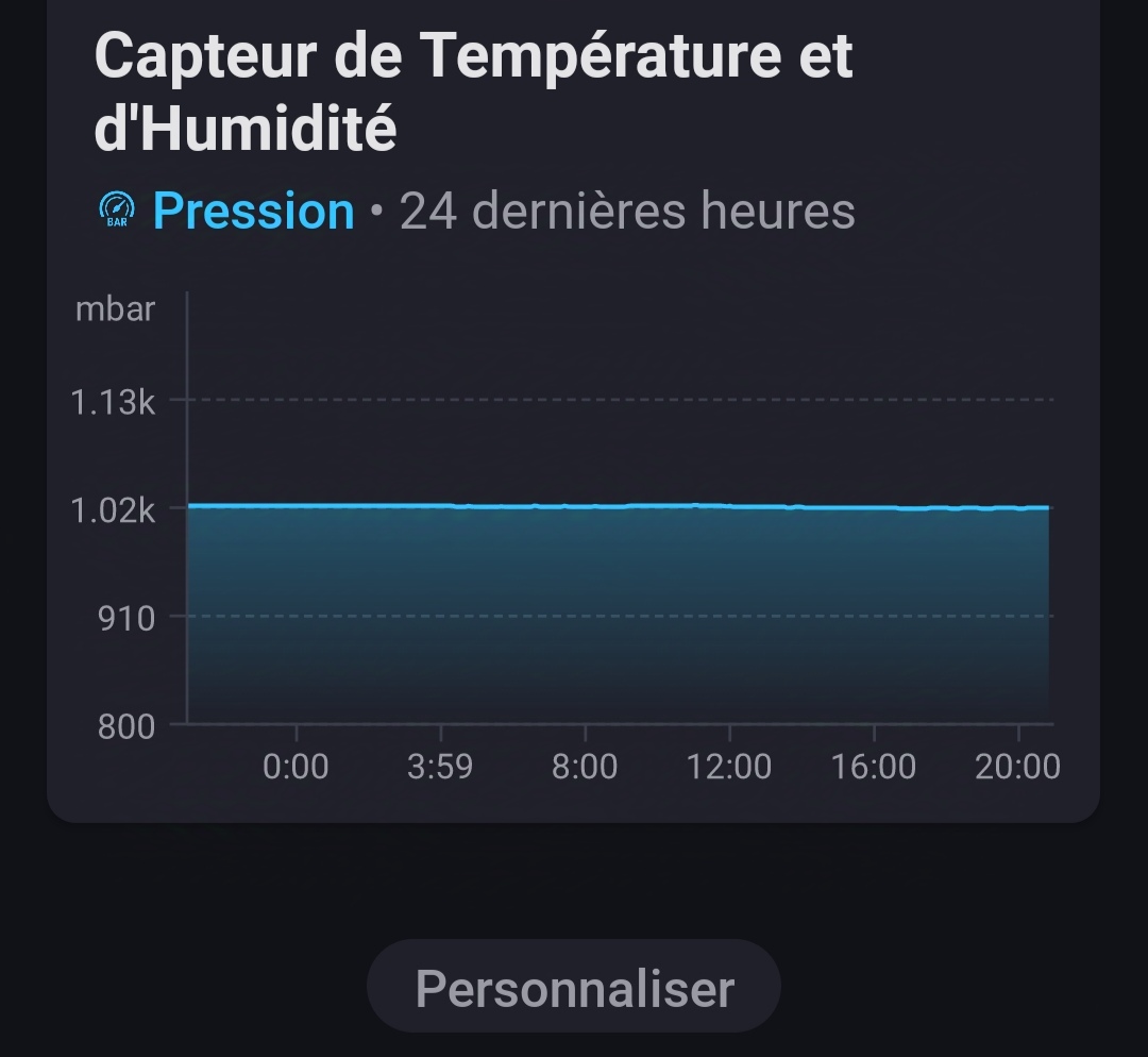

Serait il possible d’ameliorer l’affichage des courbes de pressions avec une valeur de référence selectionnable manuellement en fonction de l’altitude d’habitation puis un affichage de courbe +/- 40 ou 50 mbar pour que cela soit exploitable car la courbe en l’état n’est pas exploitable.
Merci d’avance pour votre retour.
Would it be possible to improve the display of pressure curves with a manually selectable reference value depending on the altitude of residence and then a display of a curve +/- 40 or 50 mbar so that it can be used because the curve as it is is not usable.
Thank you in advance for your feedback.
