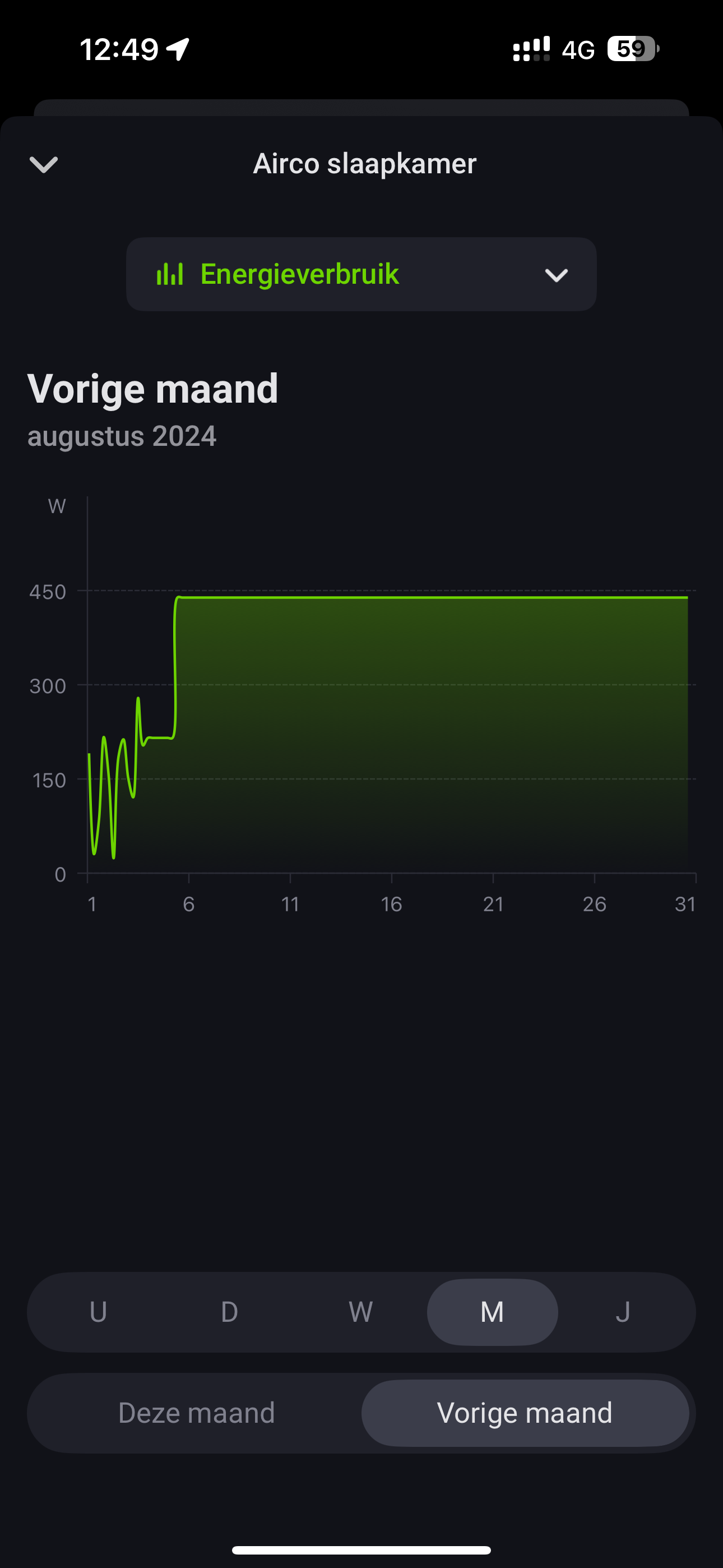

There are some reports where this switch will stop reporting the power measurements after a power cut. Even with multiple power cuts, the devices I have available continue to report it’s power state.
@Par_Ostberg @Morten_HP23 have you tried to remove the switch and re-add it to Homey?

Same issue here with the switch, it just takes a while but it is guaranteed to stop reporting the power after a couple of weeks. Switch still works after the power reporting stops. (I have 5 of them and it’s the same for all)
