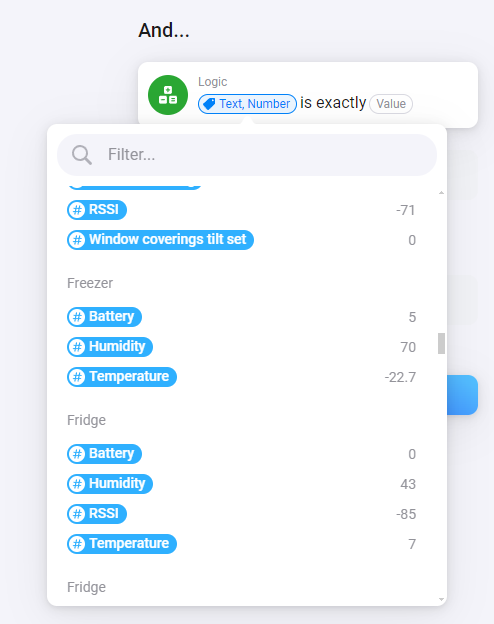

You can use the logic cards to check the temperature tag value in the AND part.
I guess the update depends on the device. If it’s a battery device it will probably report infrequently to conserve battery. Check the Advanced settings to see if there are any options to change the report interval.

Usually these devices update when there’s a “significant change”, like ±0.5°C change, and once per hour if no significant change has occurred during that time.
The app can’t help it that the device doesn’t update in a way you understand.
If the app shows the temperature in the device panel, then there will be a global tag for it. Homey provides those automatically, so, in the Logic AND card, select the tag icon and search for the name you have given the device. Note: only Logic cards for numeric values will show the temperature tag.
Thanks! I didn’t know the variable was set globally - probably a newbie mistake.
Thanks for the assistance!
