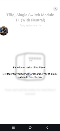

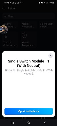

My english i not that good but i am trying.
I got these message.
Same here, they worked perfectly with hp2019 but with hp2023 its almost impossible to add them. Sometimes after 20 attempts it works, but they fail after a while and then you can only switch them on/off and the power measurement doesn’t work anymore.

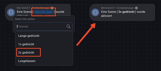

Thank you but can you explain how to do it? i am not use to this kind of things and it is difficult to understand to me.
The only thing you have to do is to add the already shown flow card (When…) to your flow, click the empty box (Select the action), select “2x pressed” from the drop-down menu and that’s it.
This flow will only be started if the button is pressed quickly twice.
(Screenshot of an Aqara Wireless Mini Switch (2018))
However, we still don’t know which device you are talking about.
Oh thank you! I have the wireless mini switch bdw.
It was really simple, I don´t know how I wouldn´t find this. Thank you very much

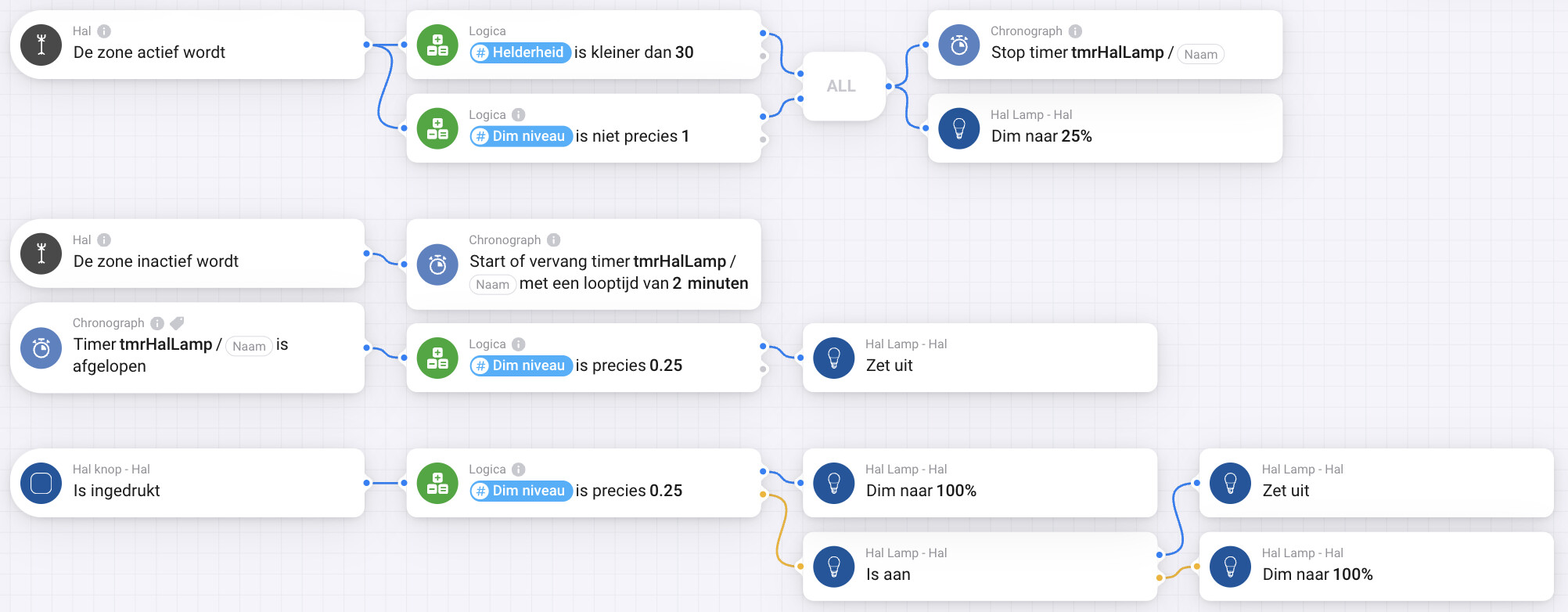

Hi, I just added some Aqara motion sensors and noticed that you can check for motion OR check for a change in light level. But you can’t trigger on motion AND check the light level. I would like to trigger some lights based on motion after dark (or even if it’s really dark weather) but that doesn’t seem possible. Am I wrong or is this card missing?
Please use the search function or read the entire thread. This has been explained multiple times. I don’t mean this in a negative way. But if you show the community you are not willing to do the minimum effort. Please do not expect more than minimum response.
Again this is meant as positive feedback.
Kind regards,
Rob
With no AND card for light level, I had to add a lot of extra flow. But this is what I built (sorry it’s a bit messy, I had to fit it onto the screen somehow):
I’m sure some can do better, I’m no developer so I doubt this is the most elegant solution. But it works :slightly_smiling_face:
Couldn’t find anything appropriate @Rob-Spark (maybe I didn’t look hard enough), but I achieved what I wanted and shared the result for others.

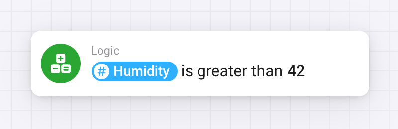

This is usually done using standard Logic cards and tags:
