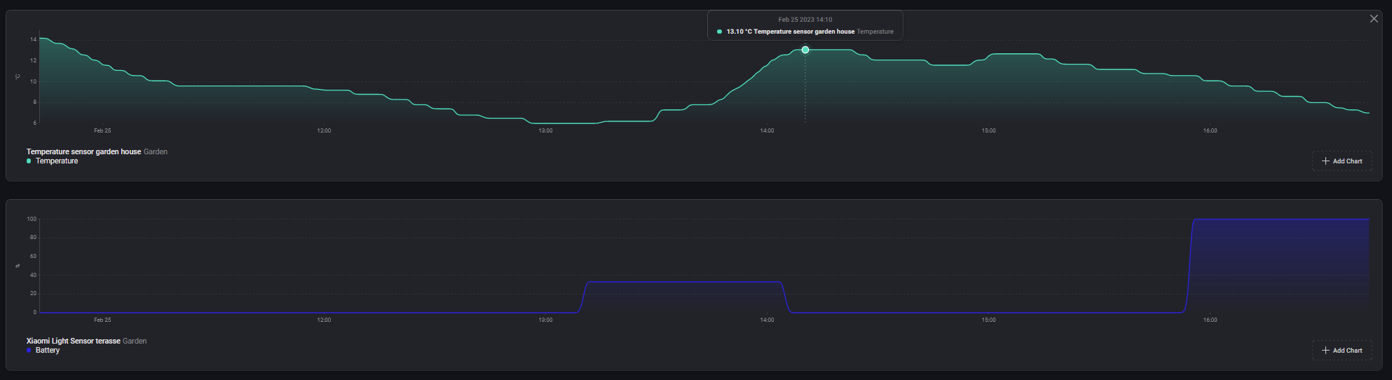

Hi, it’s still the same unfortunately for GZCGQ01LM… it oscillates the same way as before, between 0% and 33%
obrazek
This year view :
(yes the sensor is outside but as you can see, now with 14C outside still no change)

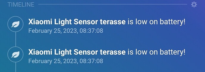

FYI @TedTolboom …the battery alerts are incoming twice

Nothing new. Mentioned already in this post.
Meanwhile, I think that the Xiaomi Light Sensor “low on battery” notifications have something to do with low (outdoor) temperature. Since the (outdoor) temperatures are higher, I no longer get “low on battery” notifications. So it seems to be a hardware behavior of the Xiaomi Light Sensor, which probably can’t be influenced by Ted.
But of course, double notifications should not occur.
Never happened to me before, so it’s new for me after installing the latest version. I believe, if anyone reading those inputs, any experience is relevant, when shared.

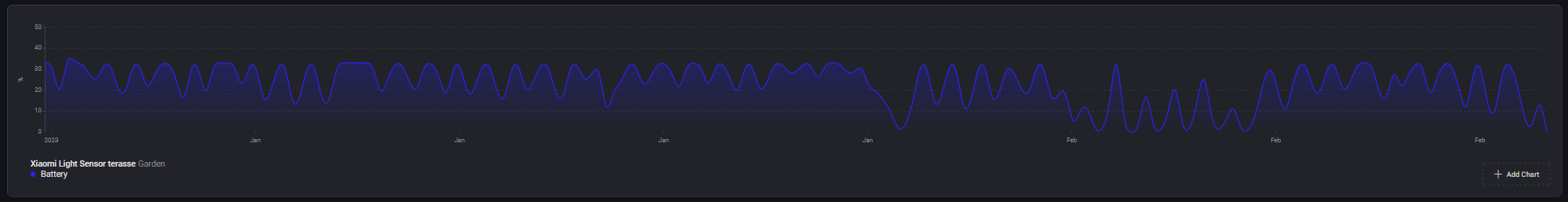

Could be the case, but as my sensor constantly report 33% for last 3 months and then suddenly fluctuates to 0%, while it’s actually NOT the lowest temp outside, I don’t think it’s the case for me. Also I have several temp. sensors outside (I mean not in tempered areas) and those behaves just fine, I mean they lower the battery SOC but not to 0% but eg. from 70% to 63% while that battery is even quite old (several months) etc. But naturally low temp. can for sure influence battery capacity, that’s clear - however it didn’t happen ever before prior to implementation of new voltage/battery measurements.
Take a look on the example :
  • while it was outside 13C, Xiaomi Light sensor jumped to 0% SOC - and when the temp. dropped to 10C, light sensor reports 100% SOC… and nope, I didn’t change the battery just now.

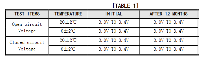

Are you sure Robert ? I’m for sure not an expert so I could be absolutely wrong but looking here : https://github.com/TedTolboom/com.xiaomi-mi-zigbee/commit/605f5e60ea96d4d13ff512b6e97c597488501d3d
const parsedBatPct = util.calculateBatteryPercentage(batteryVoltage * 100, ‘3V_2850_3000’);
Previously option was 3V_2100 … what is interesting, I see that this “battery” option is used also in case of MCCGQ11LM but it has different battery then GZCGQ01LM - it’s CR1632 vs CR2450, seems though it’s the same initial and end voltage 2V …
(on continuous discharge at 20°C under 7.5kΩ load to 2.0V end-voltage)

Does it means that in case of 3V_2850_3000 the min. is 2.85V, max 3.0V ? If so, then for CR1632 and CR2450 it’s wrong, 0% shall be <2V - but I have no idea what the sensor actually measure/reports.
Btw I have measured battery right now and it shows 2.77V , while reporting 33% (…and dropping to 0% as mentioned) - 2.77V shall be rather 77%… ? I know that the discharge curve is not linear though.
Btw also on temperature influence @DirkG … still it’s hard to believe and maybe it’s just “paper”, they even specify battery operational temperature range quite large -30C-70C.
