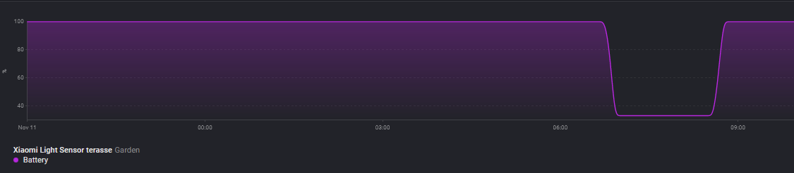

Same here, every hour several battery reports … empty, full, empty again. Started after last update, before no problems. As far as I can tell no other issues.
If you are speaking about lumi.sen_ill.mgl01 - indeed, while I have new battery, I see quite odd behavior as well (but works fine)
