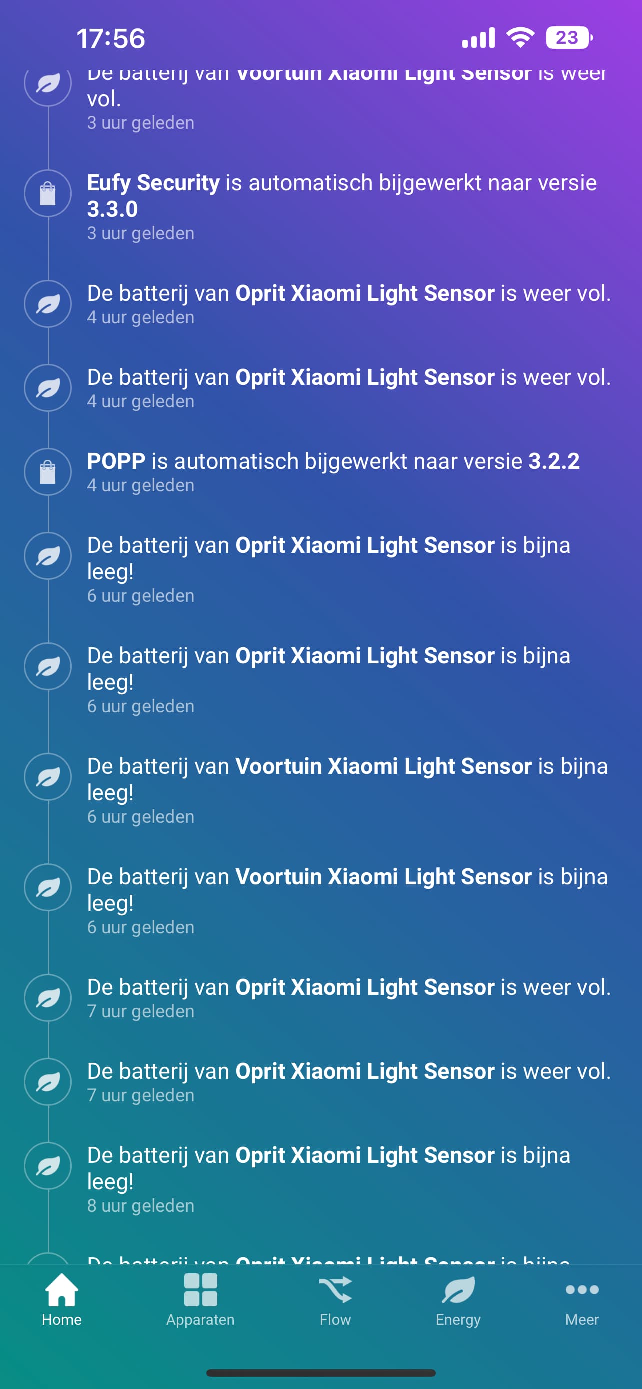

@TedTolboom hi Ted, sinds the new update I got this:
Can you send me a diagnostics log when possible just after an update full / empty?
I have near the same problem with one of two Xiaomi Light Sensors as Yannick.
On 09.11. at 15:44 I updated the app to version v1.5.0, at 16:36 the first battery notification came.
But because the battery alarm only came on for one sensor out of two, I assumed that the battery was actually dead.
Yesterday I replaced the old battery with a new one and the blue LED on the sensor flashed briefly.
Since then, however, no more lux values are transmitted, but the battery shows now a capacity of 100%.
I tried to do an interview in Developer Tools, including waking up the sensor of course.
I tried to add the sensor again without deleting it first.
Both attempts without success.
But I am not sure if it is due to the app update or if the sensor is defective.
Diagnostic Report: 7b59c8dc-0652-4cc6-9693-dea78f6d7bf5

Since the last update I have trouble with the batteries. it is empty and after about an hour it says they are full again and that a few times a day. I didn’t have that before.
It is only on the Lummen devices. The other devices works good.
