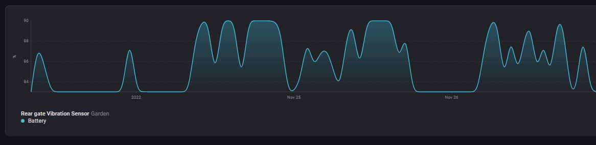

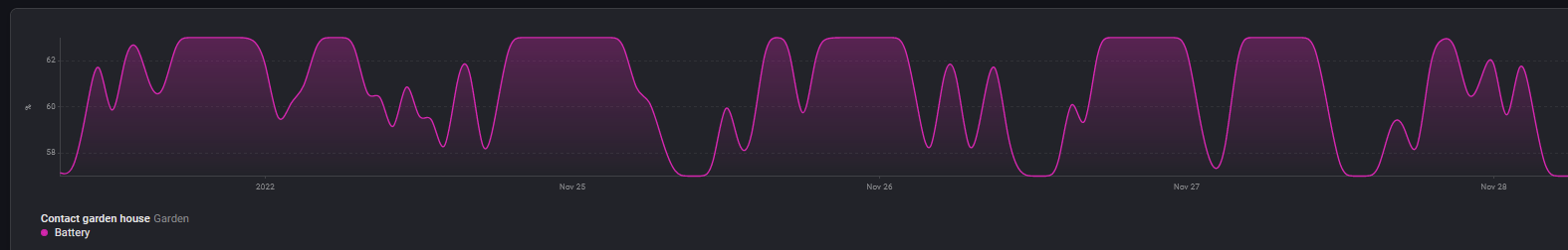

not related to the P1 sensor many many people were waiting for :wink: , but would you have any idea why, since implementing new battery monitoring, it is so misbehaving on lumi.sen_ill.mgl01 [changed battery bring to improvement] ? Rest of sensors seems are flapping as well but not so heavily, sharing few graphs…

lumi.sensor_magnet.aq2
lumi.sensor_magnet

lumi.vibration.aq1

I’m looking into the issue in parallel.
So far the received diagnostics reports (thanks all for providing them) don’t provide a clear insight in the cause.
The battery lid of my sensor is failing causing intermittent reports, will need to order a new one to do additional testing.
A small fluctuation of the battery percentage level can occur since it is based on the reported battery voltage (only).
