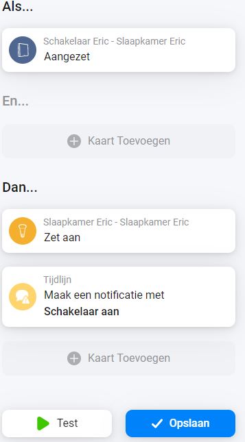

I have the same problem.I will explain how I connect the Aqara H1 EU (single rocker) with neutral. I actually use the Aqara H1 as a zigbee router only the phase and neutral connected. so the lamp (PH HUE) is always live.
When I press the buttons, sometimes the lamp turns on, often I have to press several times. But the strange thing is that the lamp just goes off after a random time.
See my flows, I’ve added notification so you can see what’s happening. but on the notification attachment. I never pressed theswitch H1 to go off. I think the off signal comes from the switch H1 at an x ​​time. hope there will be a solution.
