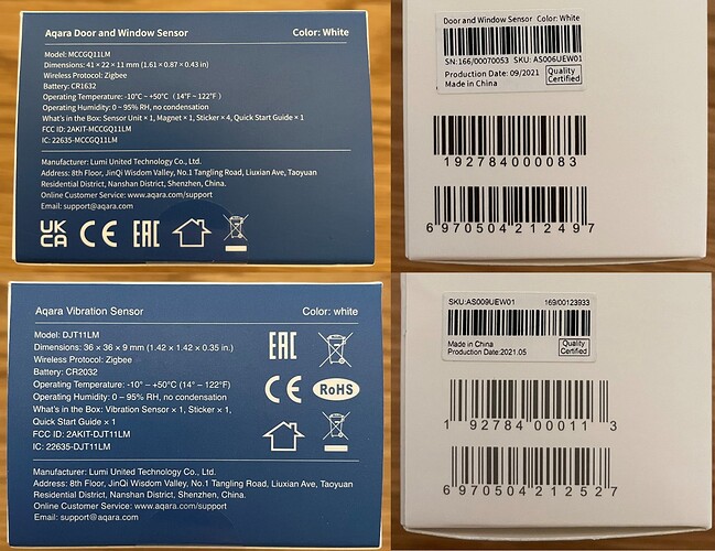

Can you check on the device or on the packaging of the Vibration sensor what the modelID is of this device? Like DJT11LM for the vibration sensor.
Please find here under the informations displayed on the packaging.
Aqara Vibration Sensor:
Model: DJT11LM
FCC ID: 2AKIT-DJT11LM
IC: 22635-DJT11LM
SKU: AS009UEW01
SN: 169/00123933
EAN: 192784000113, 6970504212527
Aqara Door & Window Sensor:
Model: MCCGQ11LM
FCC ID: 2AKIT-MCCGQ11LM
IC: 22635-MCCGQ11LM
SKU: AS006UEW01
SN: 166/00070053
EAN: 192784000083, 6970504212497
Thanks a lot!
Both of the modelID’s are supported by the app.
So when you are not able to add them to the Bridge will have other causes.
Can you try to disconnect the power of the bridge, reconnect it and try to include the devices?

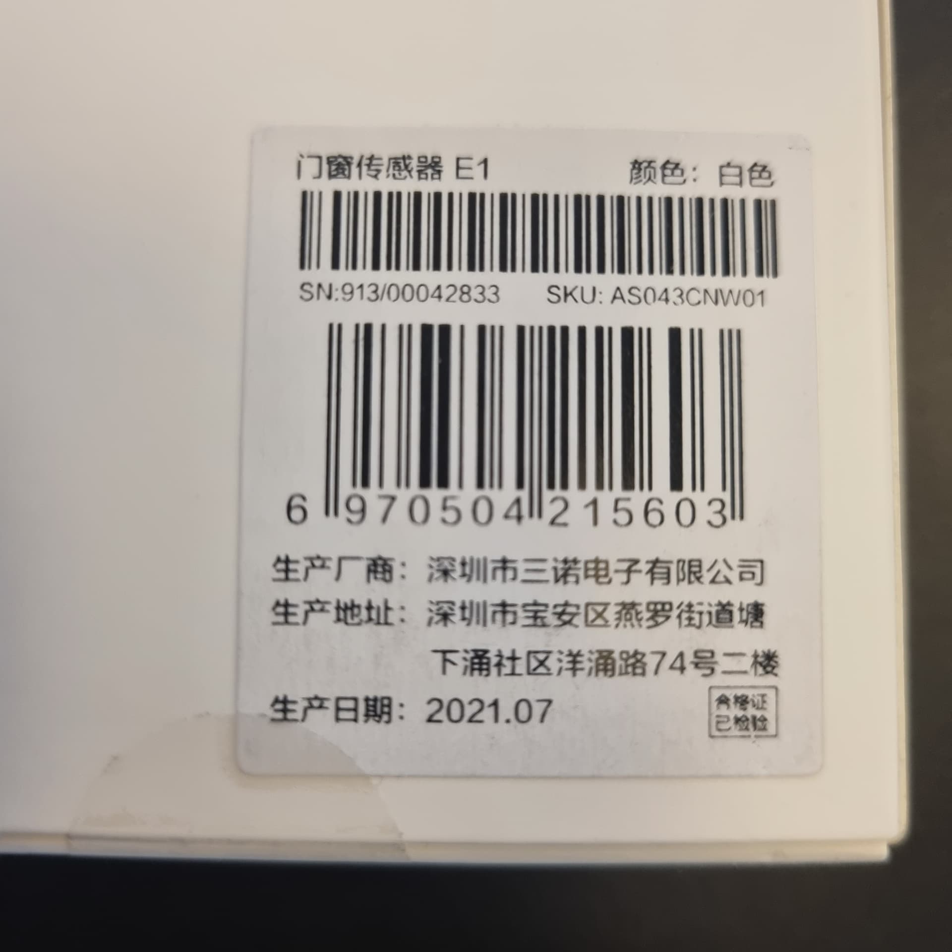

Hi Ted
i bought 10 of these window and door sensors, recently from Alibaba one of the most popular sellers. I was surprised when i found out they didnt work. I contacted Homey who, asked me to contact you. I Hope you can help me.
see attached files.
As said in the other topic you opened; you haven’t searched this thread.
Look for for E1 and see what status the integration of these devices have.
I am doing that as we text.
But can’t search for E1 cause its too short :smiley:
Just a hint: search with the browser search function, not with the Homey Community Search tool… :wink:
