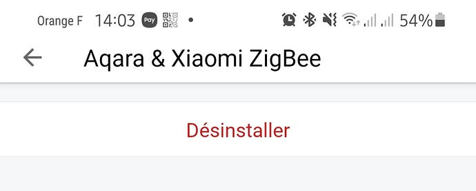

Homey app → More → Apps → Aqara App → Gear wheel → Restart App
Hello
I have only uninstall. In aqara & xiaomi zigbee app
Sorry i dont have restart
Do you have a Homey Bridge? Don’t know if this may be a limitation.
But you can restart Homey like @Peter_Kawa already suggested, right?
Yes i have an homey bridge
I have already restart the homey and try another time to pair once again but no way

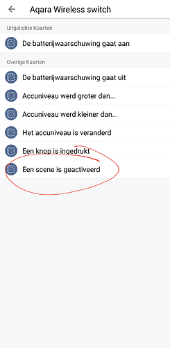

Is it possible to use the double press of the Aqara Wireless Single Switch? It seems I can only choose ‘single press’ in the scenes…
