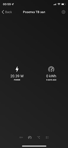

I have little problem with EU Smart Socket lumi.plug.mmeu01
I can see power in real life, but Energy never changes.
version 1.3.8
Homey version lastone.
and I have 2 sockets and all of them have same problem.
tnx
With this load (20Watt), it takes 50 hours before 1kWh is used.
at this screen TV in standby mode, normal it’s 200-300w, but another one connected to the boiler with 1500w and same result.
OK, maybe @TedTolboom can answer what the problem can be.
Can you restart the app (settings > apps > Aqara > restart), wait for 10 minutes, then send an app’s diagnostics log (settings > apps > Aqara > restart) mentioning your username
Then wait for 60 minutes and send a second diagnostics logs (mentioning your username)?

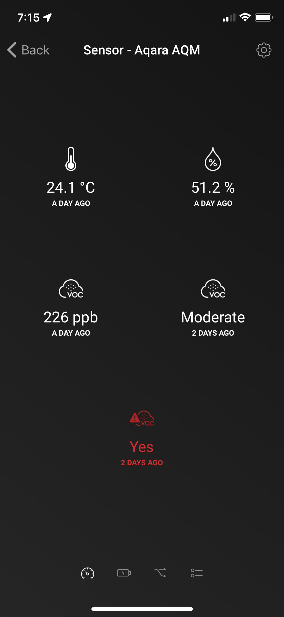

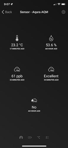

Just for letting you know, I’m testing the recently added TVOC sensor but for me it reports very rarely.
I’ve gave a demo unit to a guy who’s tested under zigbee to mqtt and his result was a lot different:
At the morning I’ve restarted the sensor. Reports more often, but far less times as it did under Zigbee 2 Mqtt.
Can you share a apps diagnostics report (settings > Aqara > send diagnostics report), mentioning your forum ID?
