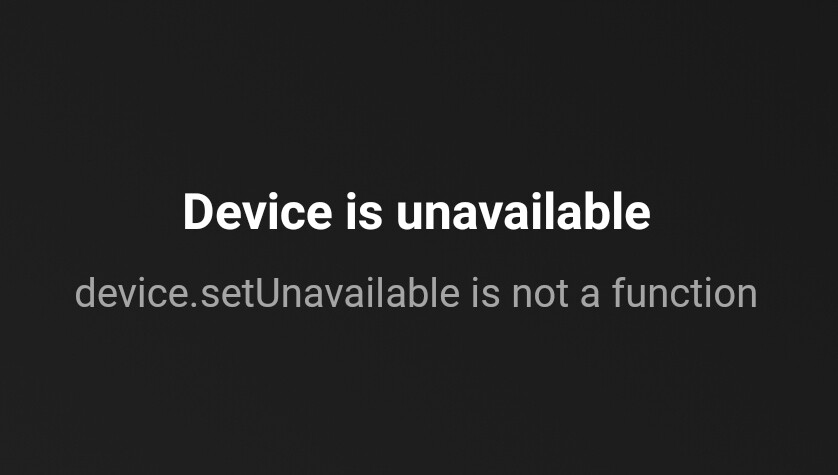

Seems all vibration sensors reports now error just after recent update (didn’t restart yet) : e517f137-a006-432b-b6be-4e5fa7a4eb87
You’re running the test build… I am awaiting some feedback on other changes before the formal release.
Should be fixed in the latest version (1.3.8).
