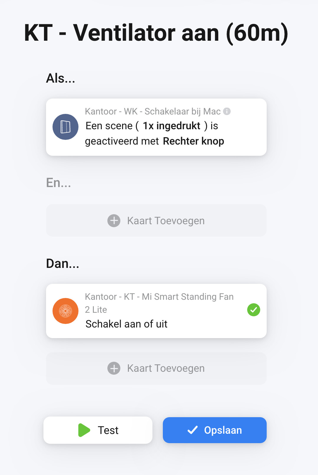

I created a flow to switch on a ventilator - the flow works when tested - but the switch does not trigger the flow.

What happens if you remove the AND condition temporary?
Start testing it as simple as possible.

Made it like this:
Still does not work with the switch (but the test works).
YW, Ernst.
The test btn just triggers the flow, it can’t check the switch.
Idk what to check next. It seems like the switch just doesn’t trigger the flow, no signal is received.
Is it connected on zigbee directly or via a router device?
And what brand of router device do you use?
It connects via an Aqara relay. I will do some more testing. Perhaps even replace the battery.

I removed the switch. Replaced the battery, tried to include it again… but it will not include.
Re-Update-Update
Removed again. Added again, on top of Homey. Took two attempts. And now - ladies and gentlemen - it works…
