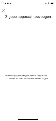

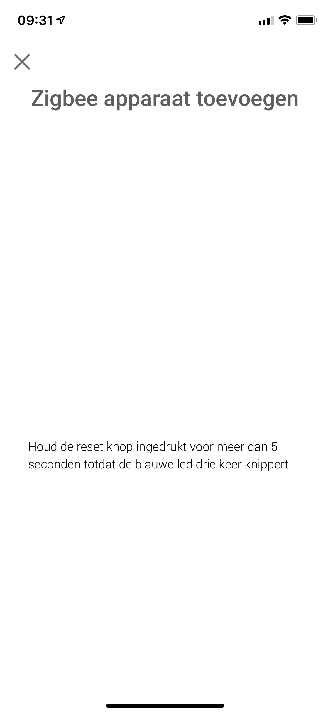

Ultimatly I switched to v5 :crossed_fingers:. Most (some minor glitches wich I manage to solve by restarting an app every hour or so by aid of a flow…) of my stuff seems to be working. However my initial problem isn’t solved. Stil not able to connect my light sensor… When I try to add the sensor the app keeps stuck on the question to push the reset button for more then 5 sec. When the sensor gives the 3 flashes nothing happens… Tried PTP, tried several distances, restarting the app,… The only response is coming from the sensor which, after his 3 flashes, gives intermittend flashes (counted like ten of them)
Homey is on 5.0.0-rc.49, Aqara app is 1.2.2
I had a similar issue with a sensor, pressed the button and the lights would blink. Eventually I changed the battery of the sensor and after that it immediately connected.
Thx for the tip, tried it but still no go… :disappointed:
This is slightly off topic, it depends on how many devices/routers you have and whether or not you are not reaching max. number of direct connections to Homey (I didn’t check if you shared this info already or not). If you do have more routers already (non battery powered devices) I would suggest to wait for mesh to stabilize and then try it again (after one day, sometimes could be longer).
For me with sufficient number of routers and with"stable" mesh always had worked following : PTP, wait for all devices to be online after reboot, restart Aqara be ZigBee app, wait again for devices to come online and then try to add it again. Btw, I’m now on 61 devices…
RC50 is already out.
For now i am at 12 zigbee devices, so not at max so far. But i ll wait for my stable mesh before i give it a new try. Thx for the advice
Got it! Resetting the zigbee network solved my problems!!!
