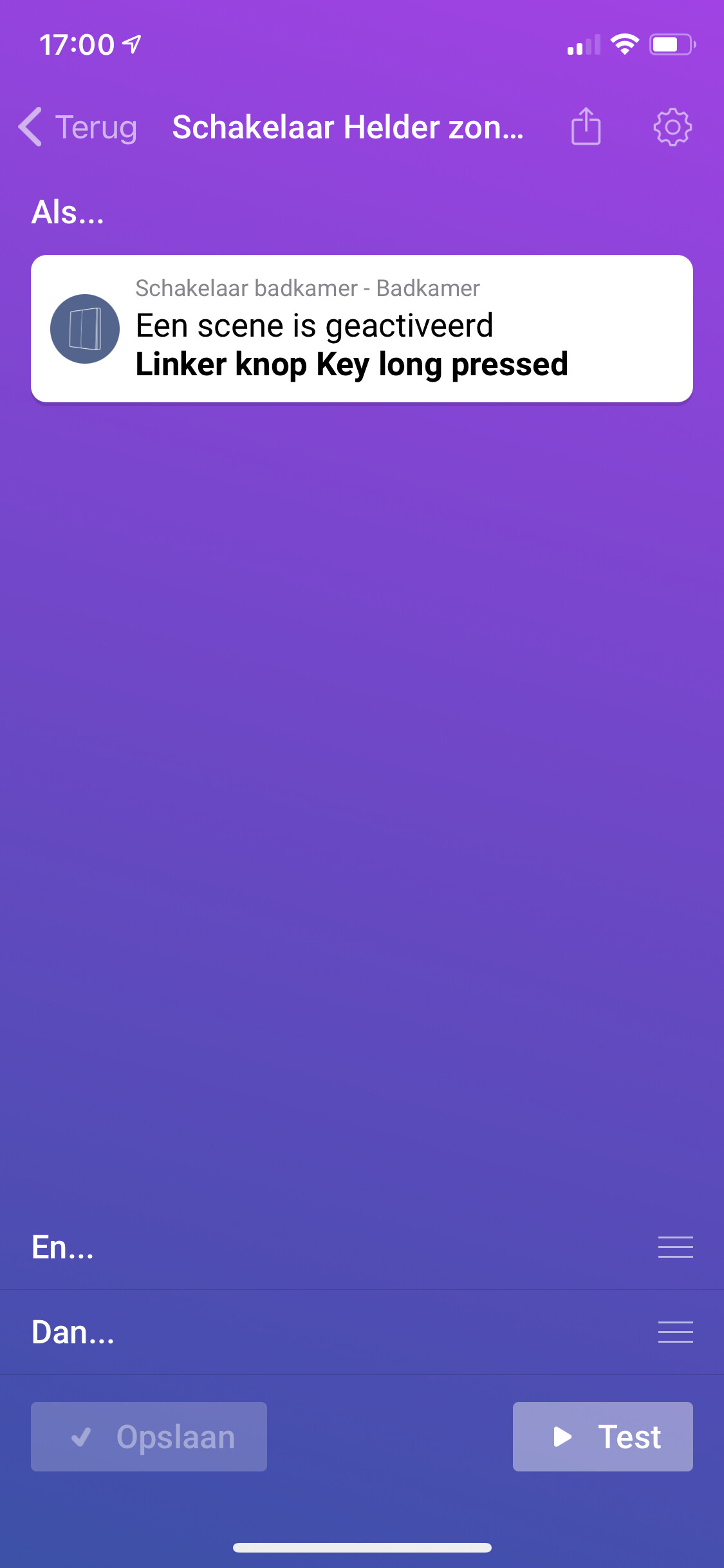

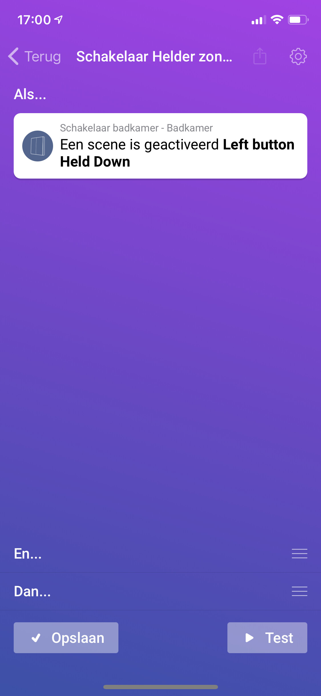

Just 1 small “issue”, for the Aqara Wireless Switch Double (2018). The ‘Long press’ action need to be manually changed to the ‘Held down’ action to work as it did before. It’s not a big issue, but maybe you wanted to know this because all other actions still work after the update.
