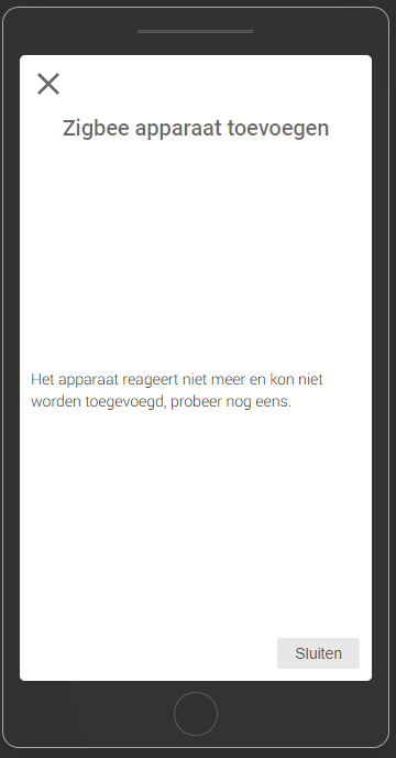

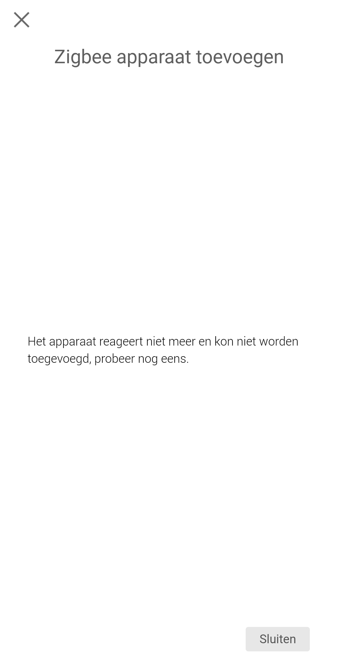

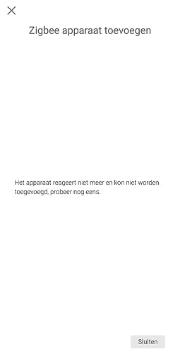

Hi @TedTolboom I still cannot add my motor to homey. If I want to add the controller homey sees the device but then the error that the device is not responding again. Do you have some tips I should definitely follow to add the device correctly?
Keep it closer to homey and try to add it again. Or add it via the developers page.
Tried to add the motor via the developers page. But getting the same error.
I’ve managed to add one motor last evening to homey, but this morning it didn’t response to a command. And gives the error the device could not be reached.
thanks for your help anyway @HarmJ and @TedTolboom
To ask Google if the window/door is closed/open.
I think you should add some extra zigbee extenders/repeaters. Maybe the ikea repeater is an option for you.
I’ve got 8 routers in my living room, and the curtain motor is right below one of them. Don’t think that’s the issue honestly. But I don’t get it either why it’s not working, bit frustrating. Last night the motor responded well, the calibration worked. Until this morning, want to open the curtain, no response.
I had the same issue in the beginning. Adding an extra router helped solving my problem. I also disconnected the battery/power sometimes. Now my curtains are stable for quite a while.
What kind of routers? Maybe you have light bulbs and somebody cut the power by using the switch? And for that reason the router constantly goes away inside homey, which could create unstable behaviour if your enddevice was relying on that light bulb for his zigbee route?
The nearest is an osram power plug. And homey is 6m away from the plug and the motor. I’ll keep trying!
Finally it worked! Thanks all!
