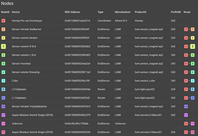

hi,
Recently my xiaomi/aqara lightsensor broke down. Replaced it and now can not get it recognised by the app. Keeps getting coupled als simple zigbee device. Tried numerous things like moving it closer to the homey, further away, PTP for 15 min, restarting the Aqara app …
Nothing helps. I’ve got version 0.8.0 of the Aqara&Xiaomi Zigbee - app. My Homey runs 4.2.0 app version 6.2.0.652.
Got13 Zigbee devices coupled with the lightsensor as unknown device. Any ideas on how to solve this problem?

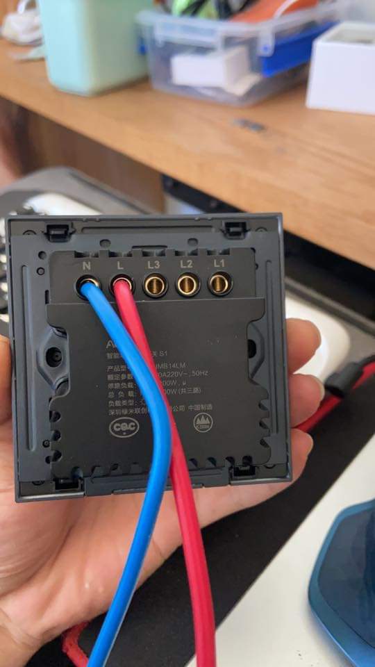

Are we ready to include this? Aqara panel S1. :scream::exploding_head::innocent:
It looks like it’s a controller device.
Nope, and you can’t buy it anymore.
(for the moment?)
