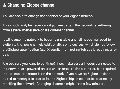

Yes - you can select channel on Homey Developer Tools, I’m looking for someone who already tested that :wink:
obrazek obrazek
You can find some experiences posted on the forum: https://community.homey.app/search?q=changed%20zigbee%20channel%20order%3Alatest
I did a Zigbee reset on V5 firmware and as a result Homey changed the channel from 11 to 14. Maybe that is a new default, maybe it scanned to see which was best, I do not know. What I do know is that all devices including Aqara stuff that used to need to pair next to Homey and took ages to pair now pairs in a second, in it’s rightful place. But also there, no clue what is owed to the new firmware and what to the new channel. I own Hue, Innr, Aqara and one Tuya, all worked. Come to think of it: the one Tuya didn’t work before, was in constant pairing mode and connected first. Maybe that was on channel 14 to begin with?
Zigbee devices have to scan all channels during pairing, because they don’t know which channel the controller is using. It’s more likely your network was experiencing a lot of interference (perhaps from WiFi).
The 2.4 GHz wifi band here is a mess, at some channels Wifi is pretty much unusable, so that is a fact. Wish Homey itself supported 5 GHz or, even better, wired through USB dongle. Already put in a request for that.
