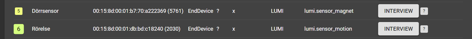

The update worked very well for me, but I have some questions regarding a very few of my devices. They cannot show the mesh routes:
Some tried to just re-add them without removing them, this will actually remove the old device and add a new one, that also needs to be added to the flows they were connected to. No worries, I can do this. But since there are so many bright people here, I figure that I can at least ask the question. Is there any other way to just include the devices in the network?
They do work as they did with 4.2.0, but it doesn’t look good. :slight_smile:

Give it time (some say it can take up to 9 days) or remove / connect. Both are valid options, the latter has more impact.
And yes, has been handled like a dozen times already. But no worries.
Thanks @Martijn_Hoogenbosch. Yeah, I have seen that it can take several days to get the graphics updated, but I was a bit uncertain if that exact scenario was applicable for me since most aqara devices were updated in the list. I was worried that something was faulty with just these devices.
But then I know, I will let time pass and have it solved automagically. :slight_smile:
