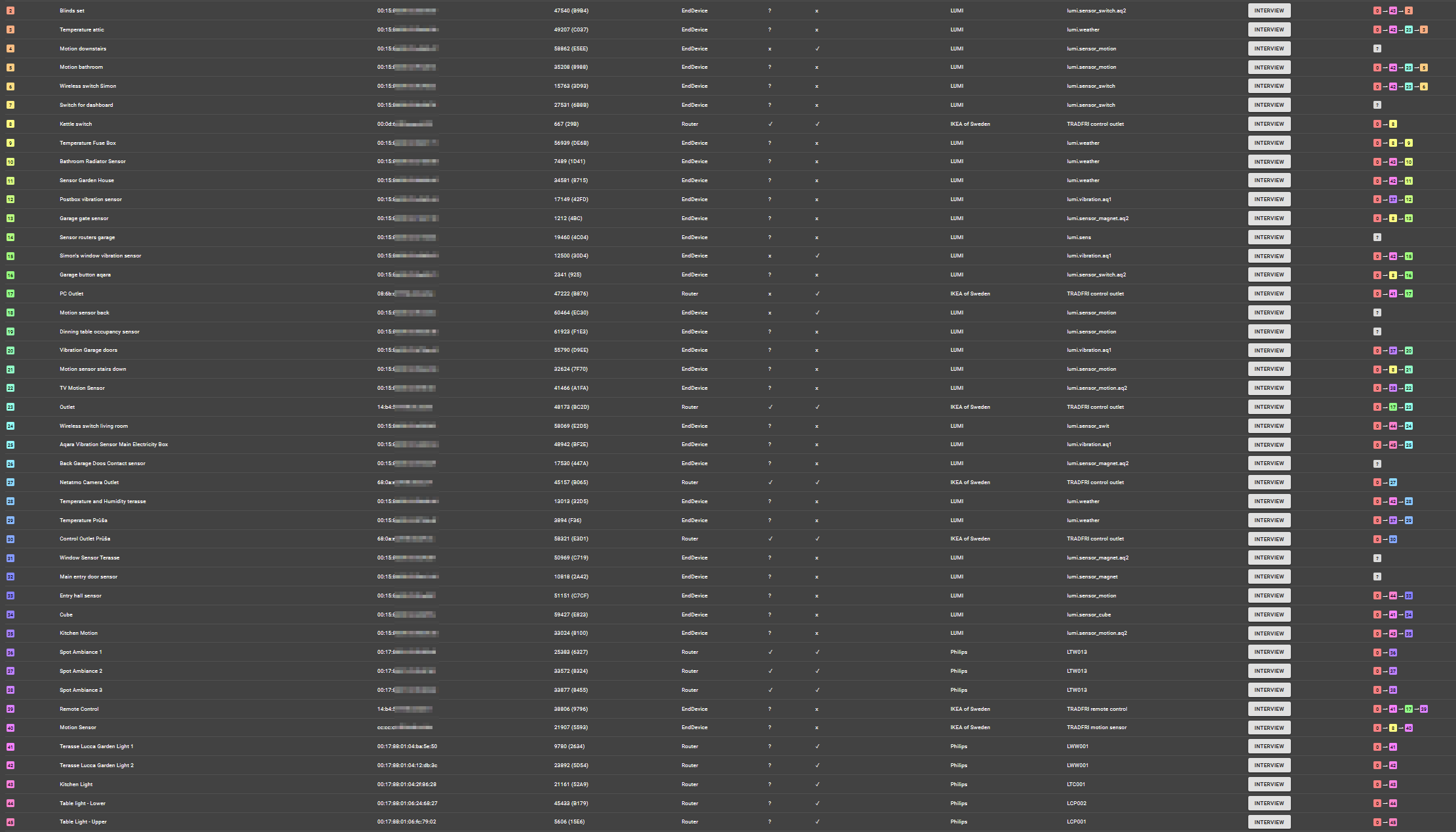

I’ve been having some issues with Zigbee lately and came up to this topic looking for a solution. I installed Version 5 tonight and with it updated the Xiaomi app version 1.0, hoping all problems were over. I keep an eye on the mesh network by visiting https://developer.athom.com/tools/zigbee. I’ve restarted Homey after take the power off for 15 minutes.
Now, i’m waiting more than 45 minutes to get a updated mesh network, this is the situation. How long does it take to get all the routes visible?

All I see is end devices, no routers. That’s not a healthy Zigbee network, and your problems are likely caused by Homey’s limit of 20 directly-connected devices (which firmware v5 won’t solve).
Add some routers…some ZigBee non-battery powered devices or even cheap routers from IKEA (TRADFI) including repeaters/power sockets…they are really cheap. Prior to adding them you might require removal of some other devices as you are already over the limit/

Because AFTER they will confirm the mesh path is stable, it will update routes… when you see ? it doesn’t mean it’s out of the mesh, it means it’s not sure yet about learned path (naturally applicable only when the device itself works :wink: )
For example this is my state after 6 days - those with ? works fine yet they are indeed not in the direct route to Homey. In some other thread it was stated the routes stabilization could even takes weeks (which is I hope not the case)
