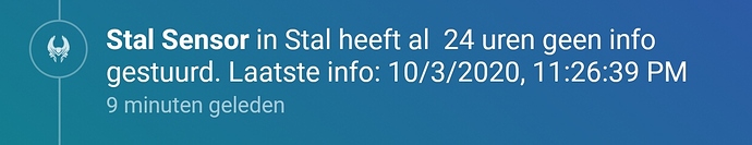

Still no routing visible after 5 days (have 4 routers and 14 end devices)
Also see this in my timeline from 2 devices.
