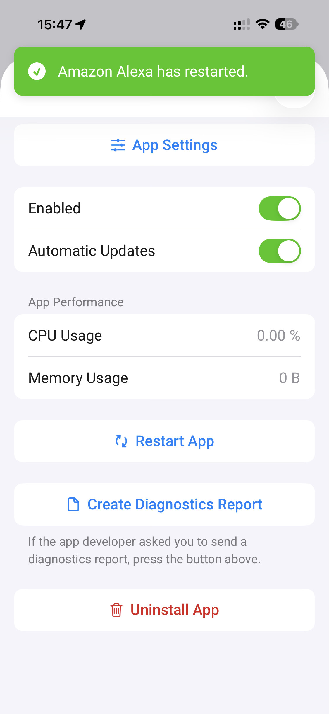

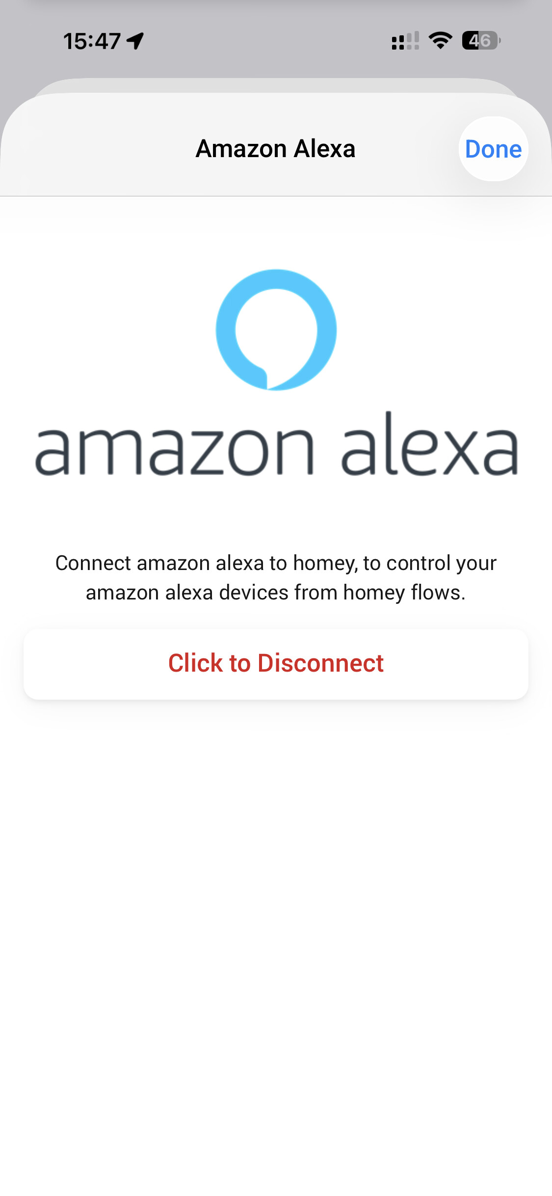

Since the update to Homey Pro 12.8.2 the Amazon Alexa app has to be constantly (every 20mins or so) restarted and the account relinked.
It will then work again for approx 20mins before having to go through the restart and relink process
Nothing else has changed other than the Homey Pro update.
screenshots attached
