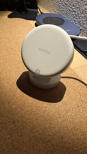

I just bought the Aqara FP2 sensor and it runs on the native Aqara app as it should.
Unfortunately, I’ve not been able to add it to Homey Pro - am I not supposed to be able to do that either using the official Homey app (the FP2 is not where you pick the device you want to add) or via Matter (it doesn’t accept the QR code on the back of the device)?

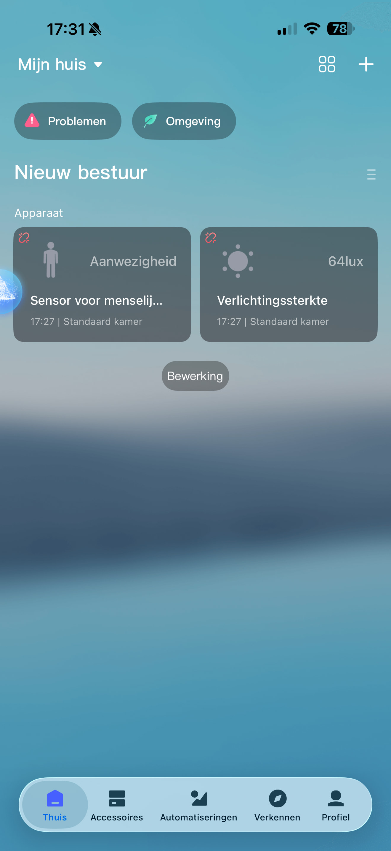

I actually got it to work now without homekit controller. I bought the M3 hub and it can utilize “Advanced Matter Bridging” where you can set up signals from the Aquara app, which again turns up in Homey as devices when you have connected the hub to Homey via Matter. I have set up a “Presence” signal from my FP2 in the Aquara app which again turns up as a matter device in Homey. With this approach you can set up other functions from FP2 such as “Someone enters from the left”, “Someone is approaching”, “Illumination drops to___” and many more. You can read more here: Introducing Advanced Matter Bridging - Aqara
