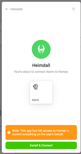

I got scared a bit by the Heimdall app as it is 3rd party made and the Homey warning message that Heimdall will get full access to my Homey pro.

No need to be scared, the app needs full access because it needs to be able to read all (motion and contact) sensors regardless of the brand, the app is open source and all apps published to the app store are checked by Athom and I can imagine they check apps that need API access even more thoroughly.
Heimdalls source code: GitHub - daneedk/com.uc.heimdall: Heimdall for Homey
