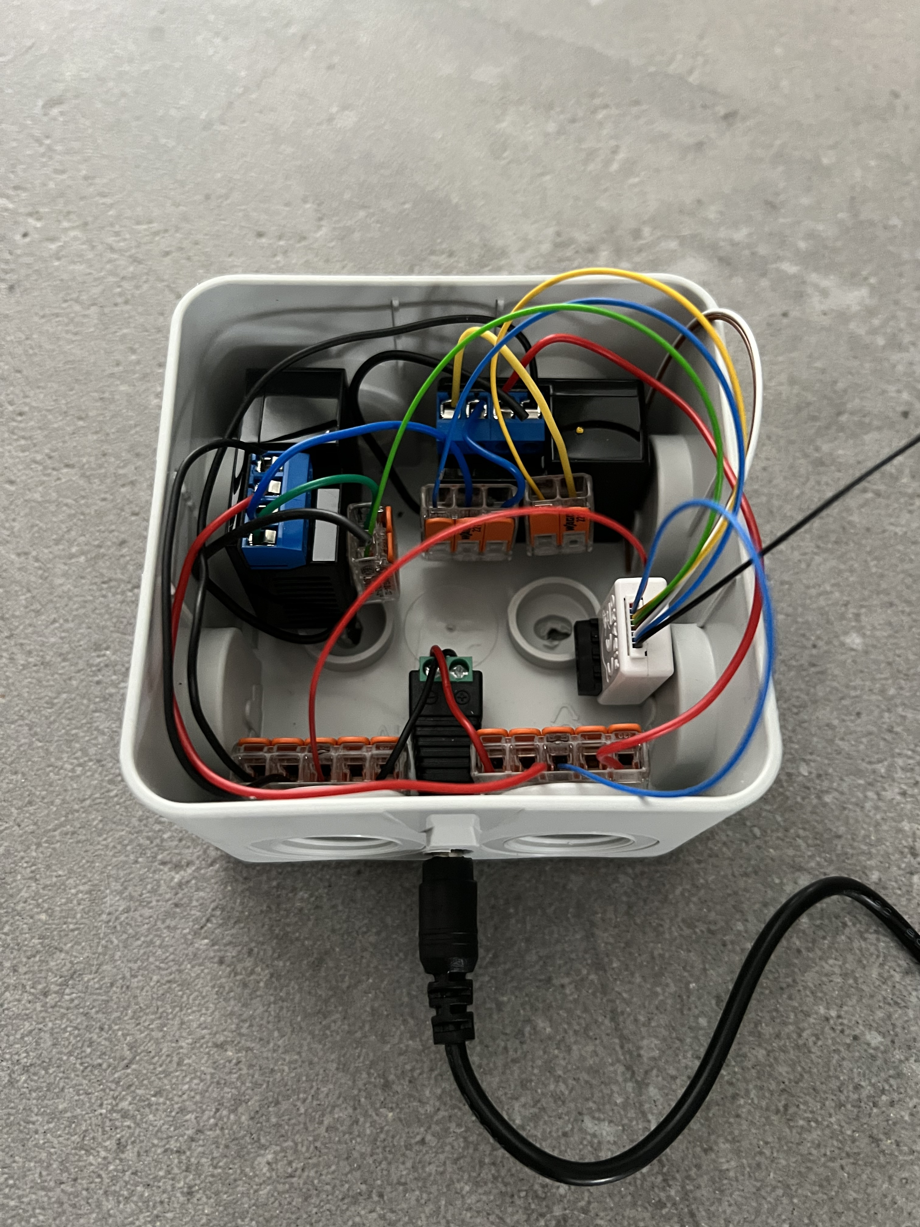

As it does not look like Ajax is ever going to make it possible to connect to other systems, I implemented the solution @Martijn_C has worked out so nicely. I only need armed/unarmed (regardless of night or not) and alarm (any kind), so I could do with just 2 Ajax relays and 1 Fibaro smart implant.
It works very nice, thanks Martijn for the nice description!
The result (have to make the connections better but lacked the materials).
