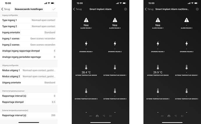

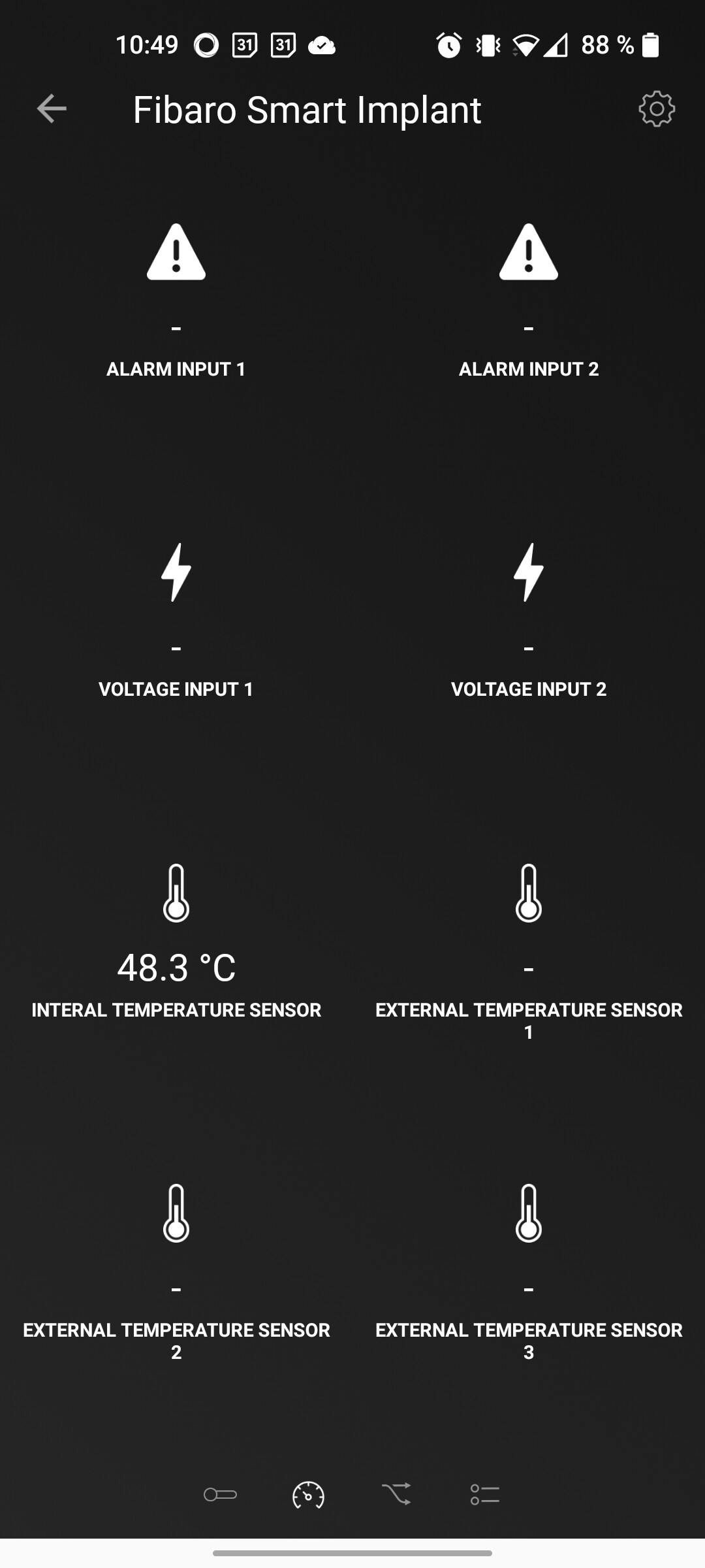

The second tab on the bottom of the screen. The one with the meter symbol. There you can see if the Smart Implant changes status after the relay changes status. Switch the relay and see what happens there.
You don’t have to comment on the article on that website. It’s me who wrote it. :slight_smile:
It always stays like this :
Oups sorry :wink:
No problem. Turn the relay on and off several times and restart the Fibaro app on your Homey once or twice. If the relay works the Smart Implant should react.
One extra tip; change group 1 to “1” and back to “1.1” a few times.
I’ve turned the relay on and off several times and restart the Fibaro app on my Homey several times. No reaction, same screen for the Fibaro’s app :frowning:
… but I’ve changed group 1 to “1” and back to “1.1” a few times, and now it WORKS ! Thanks a lot Martin :ok_hand: :wink:
Good to hear! :slight_smile:
