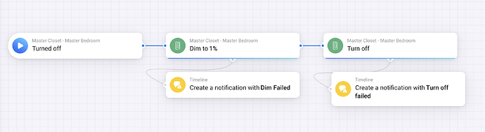

When I test it before saving by pressing the blue start on the first card, it works flawlessly. I monitor it on my phone to see it happening in real time and also confirm within the web app.
However, when I save the flow is when it gets strange and stops working. There is also no other flows with this switch so nothing would be affecting it.
The flow shows it completed successfully, but the switch is hung at 1%.

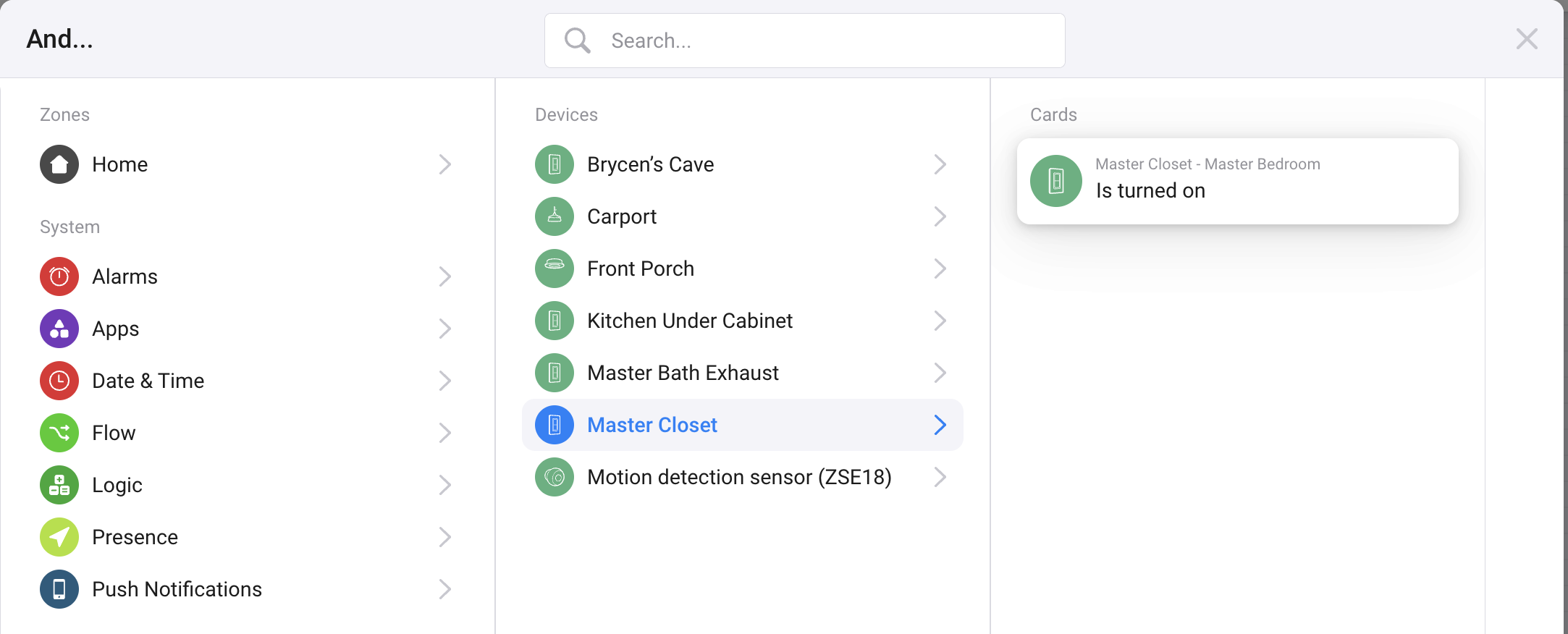

WHEN:the ZooZ dimmer switch is flipped
AND: the master closet is turned on
True THEN: dim master closet to 25% and turn off master closet

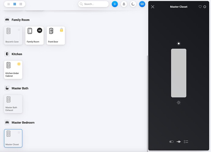

Yes I did not understand and I honestly still don’t quite wrap my head around all this. However, I think I may have confused everyone thinking that I have both a smart switch and smart bulbs. The switch is the only thing that is smart. So, the switch is the only thing that controls the lights so I can’t specify “When light x is turned off”. Which is why my only option was to construct the flow the way I did based on your feedback. I truly appreciate everyone’s help and patience with me.

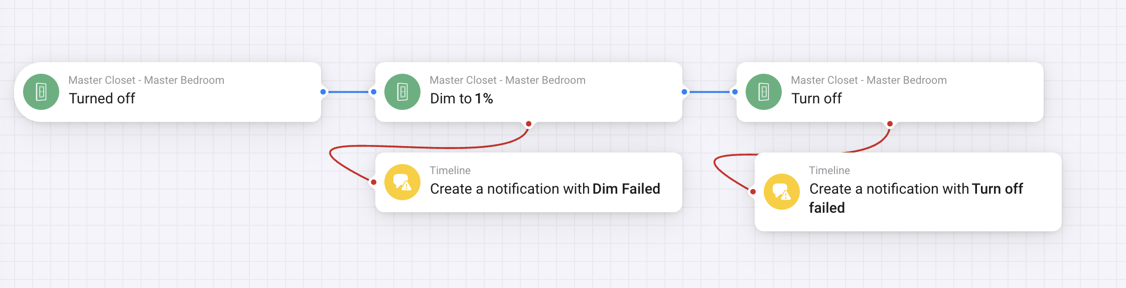

I unfortunately don’t have a WHEN for Zooz that is toggle of/on but just a Turned On, Turned Off, or Dim Level Changed. So the only way for me to copy your flow is to do the following. However, I am not sure this won’t cause the same loop I was dealing with before.

The lights turn on and off, or dim normally if no flows are defined in Homey as the switch controls the ceiling lights regardless of a hub (Homey) or not. The switch is wired directly to the lights.
I could just not be asking the right question and confusing everyone, which if the case I apologize.
To clarify:
The switch is wired directly to the lights. And the lights are not smart, just the switch is.

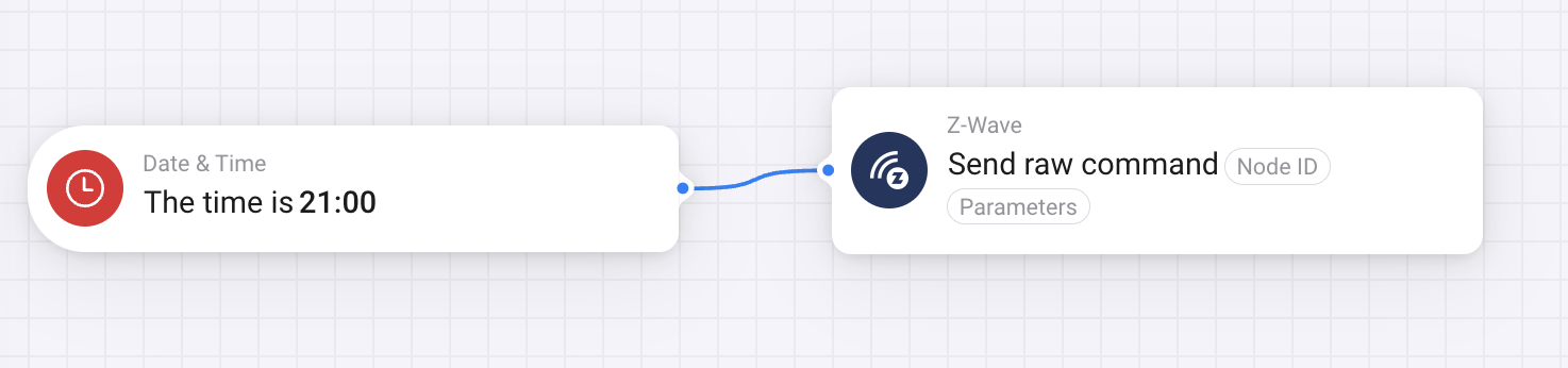

Would it be possible to use the zwave flow to send a raw command directly to the switch to set a custom dim %? This way the switch could already have the desired dim % before turning on?

With the WHEN-Card ‘mastercloset-master bedroom is turned off’
combined with the THEN-Card ‘Turn off master closet-master bedroom’ you create an infinite loop. Homey will not allow that. You need another trigger-card.
Can you do this test:
I am pretty sure that this flow will work as wanted if you replace WHEN-Card ‘master-closet-masterbedroom is turned off’ with the WHEN-Card ‘Brycen’s Cave is turned off’.
