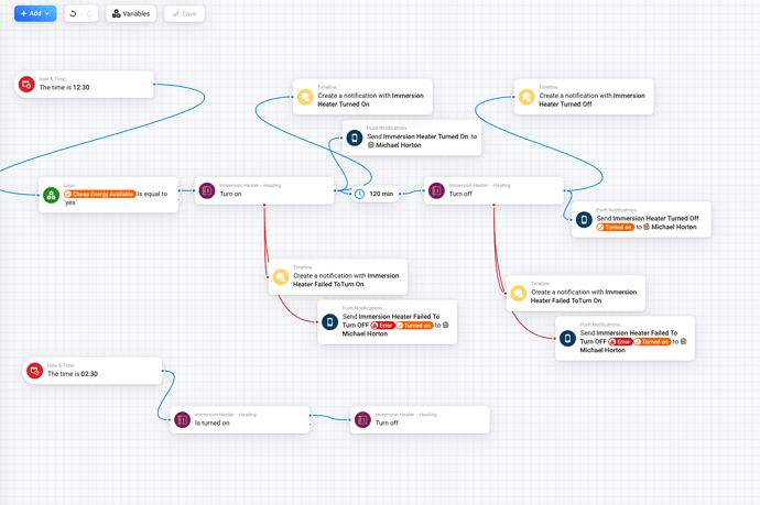

Updated and saved an Advanced Flow to this
After Saving - go an look at Devices and return and it reverts to pre saved state.
Apart from pressing save and watching it save it what else is required to force a Save to actually occur?

Finally got Save to work - delete any Cards you edited. Re add the Cards and set the correct times. then Save.
So Save does not save changes unless you delete and re-add the card. Good to know.
