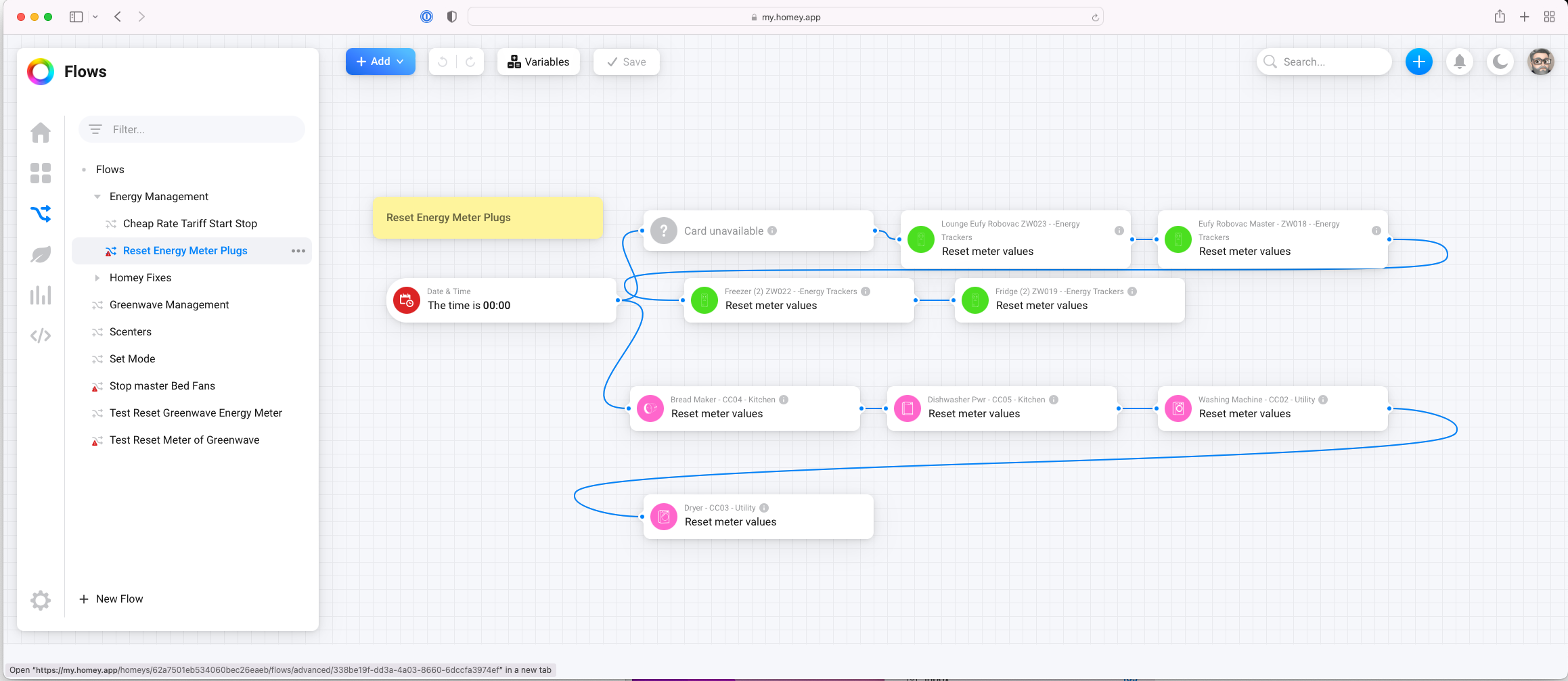

I save it and it appears to have saved
Then when I come back later it changes to this.
Is there something else I need to do to have Homey use the saved version?

Btw i see in second screenshot a card unavailable.
You can’t save if you have errors in the flow. Please fix them first.
It could be that the app for that card was stopped or you removed that device.
HI the error was removed before the save.
The Save was confirmed without the error.
The error came back AFTER the save
I have just rebuilt the Advanced Flow as despite reporting it was saved it obviously was having a problem actually saving
