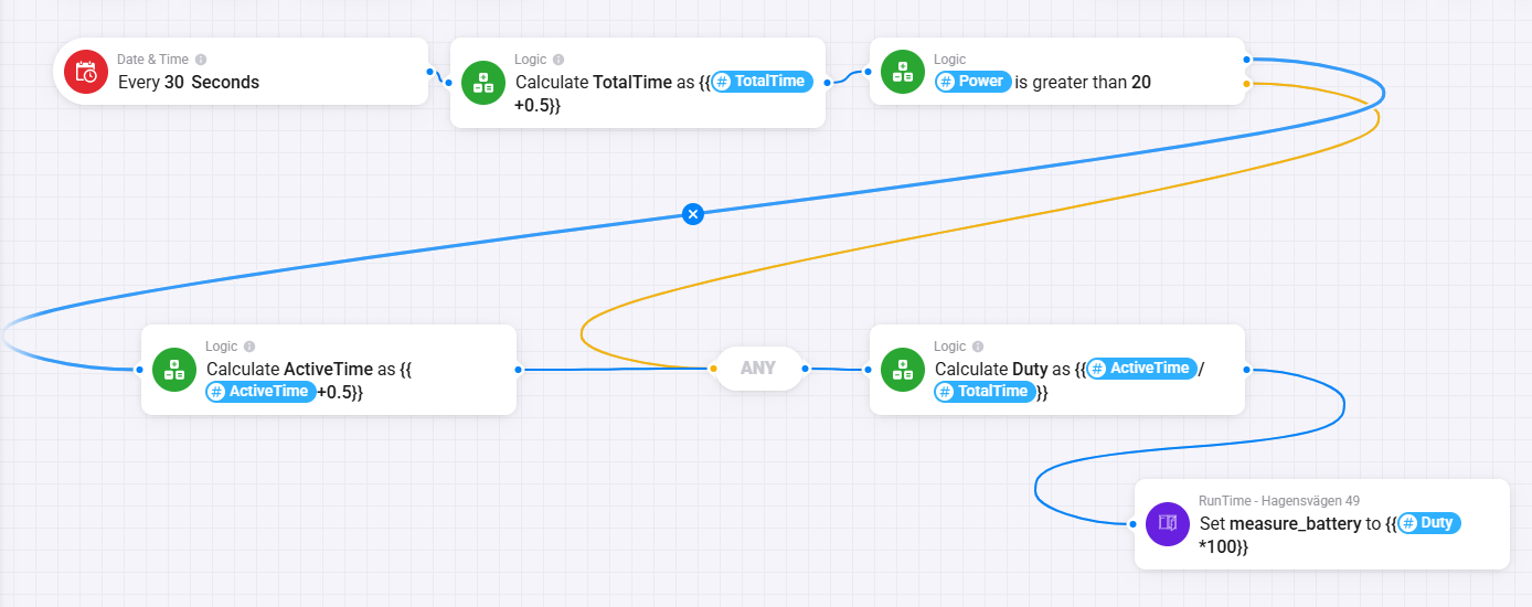

When the below flow is enabled for execution Homey crashes and restarts every 1 to 2 hours. If the flow is disabled, there are no uncontrolled restarts. I have tried to find memory or CPU starvation, to no avail. Any pointer appreciated.

Yes I am as I initialize both variables with a number >0. Both variables are also monotonically incremented and never increment above 500 before Homey crashes. However, I would in any case not expect Homey to restart if a division by zero occurred, at the most the script/flow.

I don’t see anything strange.
Maybe this helps: select all the cards and copy/paste them in a new/blank canvas.

Maybe temporarily remove the “Set measure_battery to” card to rule out that writing this value every 30 seconds is causing the issue?

You need to isolate the problem, for example by adding a message card after every card.
Sometimes a flow is corrupted, but not marked as “broken” by Homey.
One “fix” by Homey is to disable a flow without any comment or suggested fix (how lovely..).
Creating a new flow, like @Wim_Post suggested might just solve it.
Your flow design is fine though, you should be able to write values to devices quite often, but avoid “extremes” like “every second” I’d say.
Well @Peter_Kawa…
The suggestion made by @Wim_Post seems to be on the spot. I copied the configuration to a virgin canvas and lo and behold. I have not had a single crash/restart in two days.
